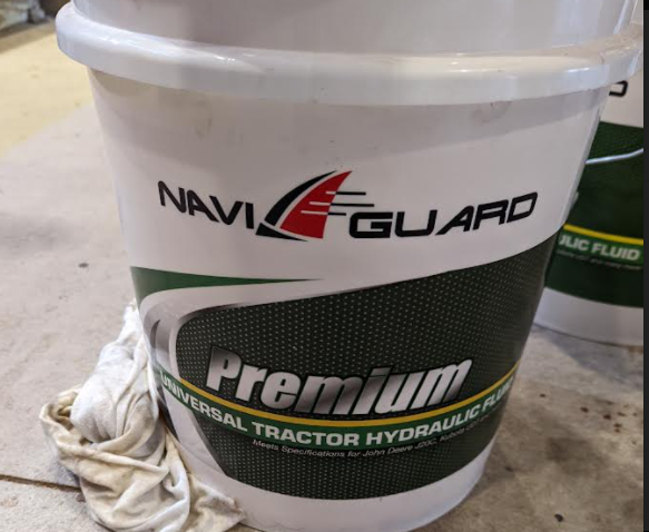

Thanks @jigs_n_fixtures. That's exactly what my guy said. I took a picture of what he recommended and attached it here.
He also recommended the following:
Gear Oil (for front axle): 80w-90. It's about 2-2.5gal for both sides
Oil - 15w-40. He likes the Rotella by Shell --- No matter what the manual says this should be changed every 50 hours
Hydraulic Fluid below. Has to be Universal Tractor Hydraulic Fluid - it's about 10gal for the whole system but about 7-7.5 on the change.
He also recommending greasing every 8-10 hours depending on what you are doing. If your are going hard, every time might be needed.
If anyone needs to know, the T474 has a sight glass for the hydraulic level which is down next to the PTO. There's a red dot in the middle and the level should be about there.

My TYM dealer recommends the premium fluid vs just universal fluid.
