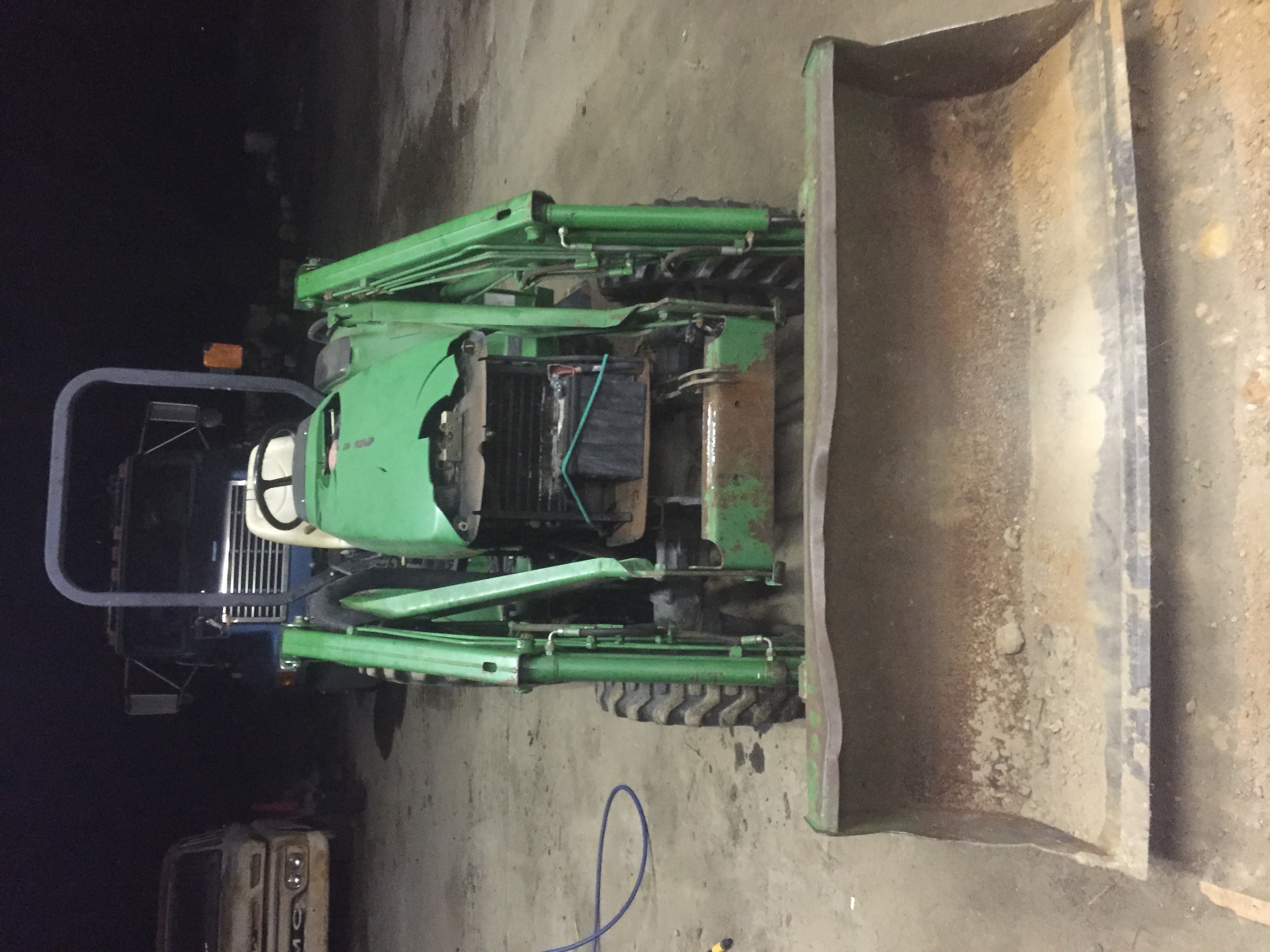

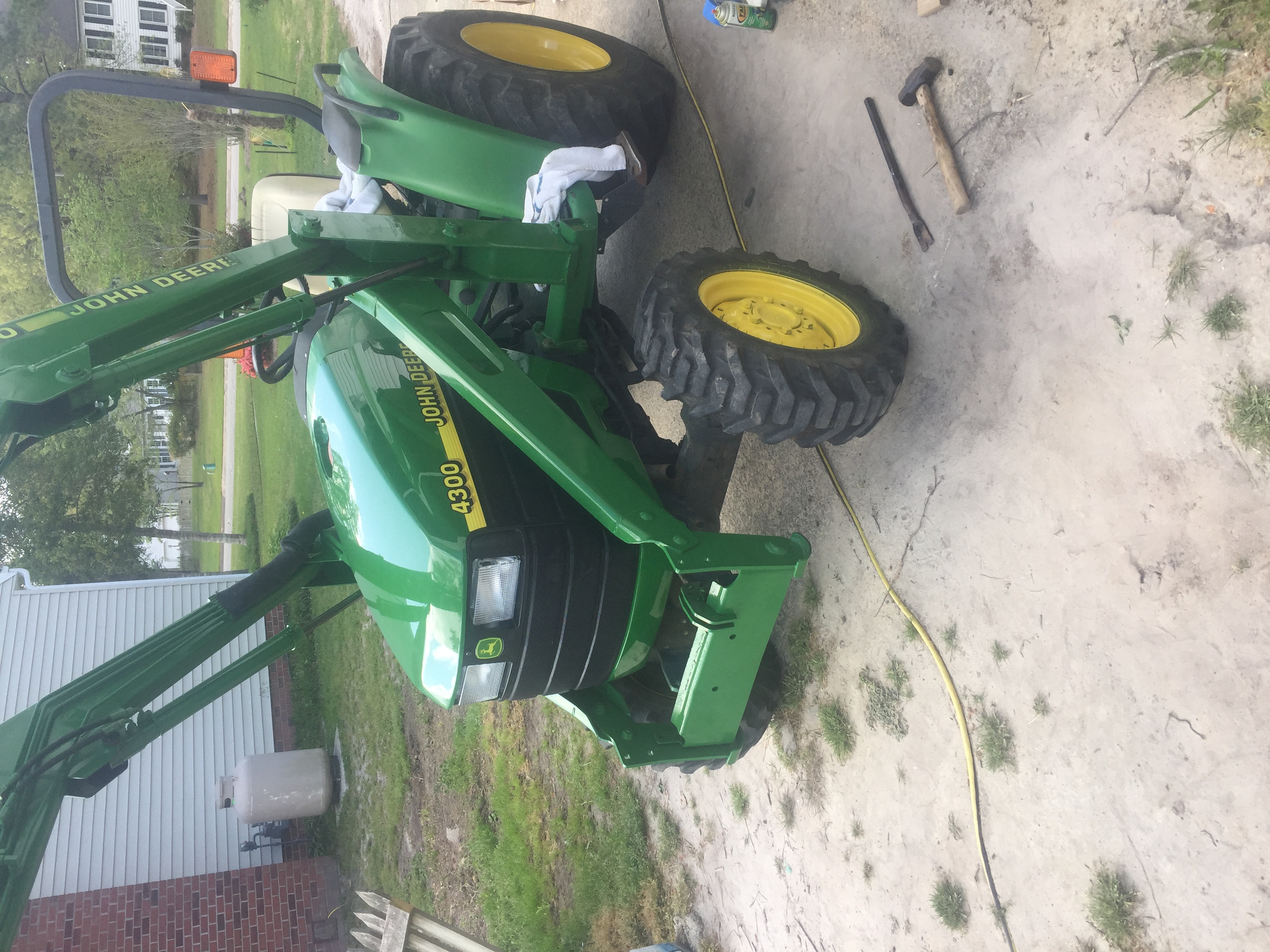

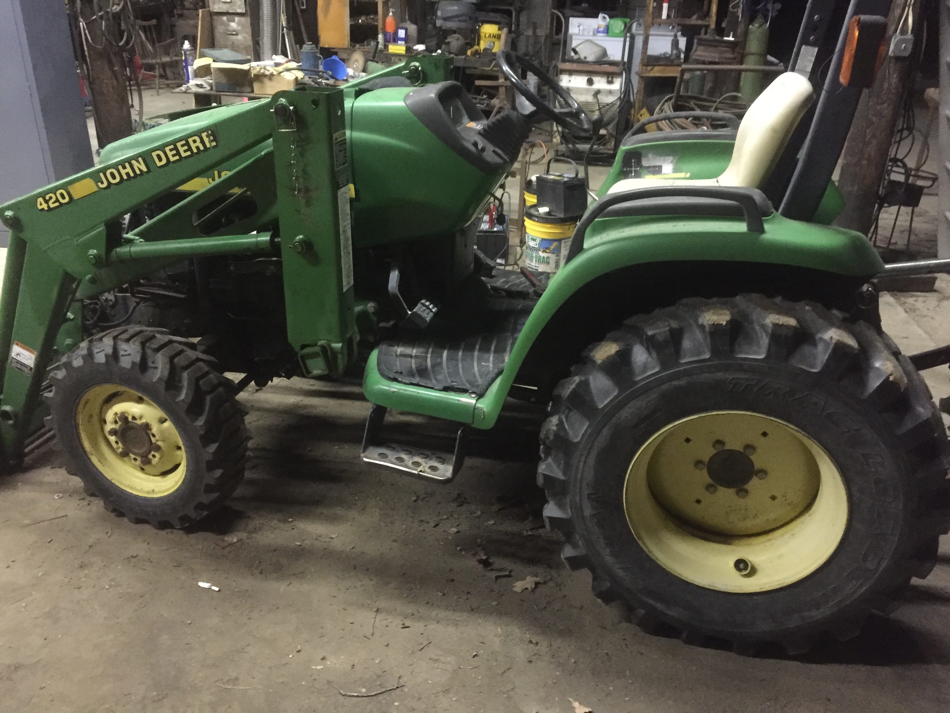

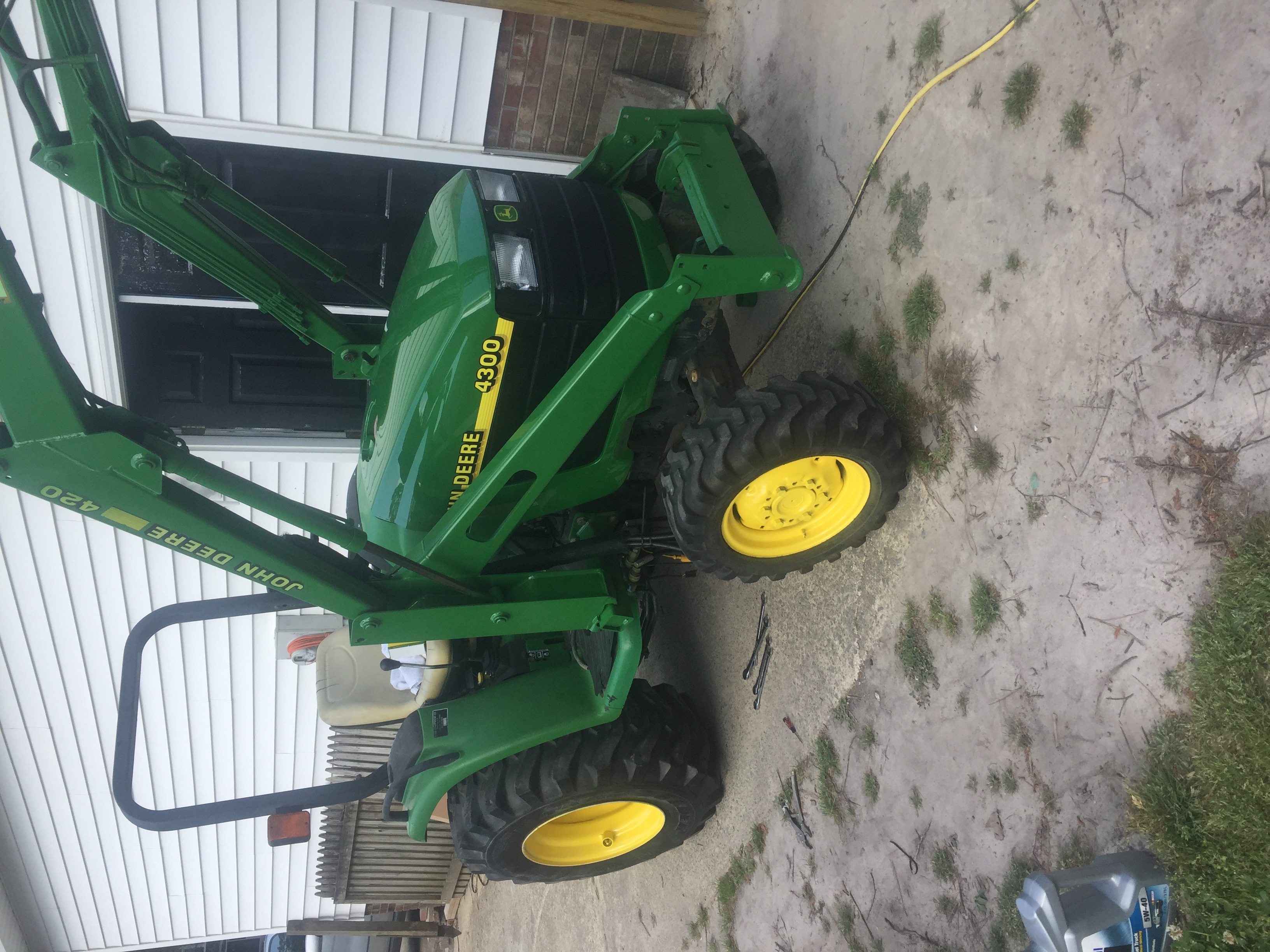

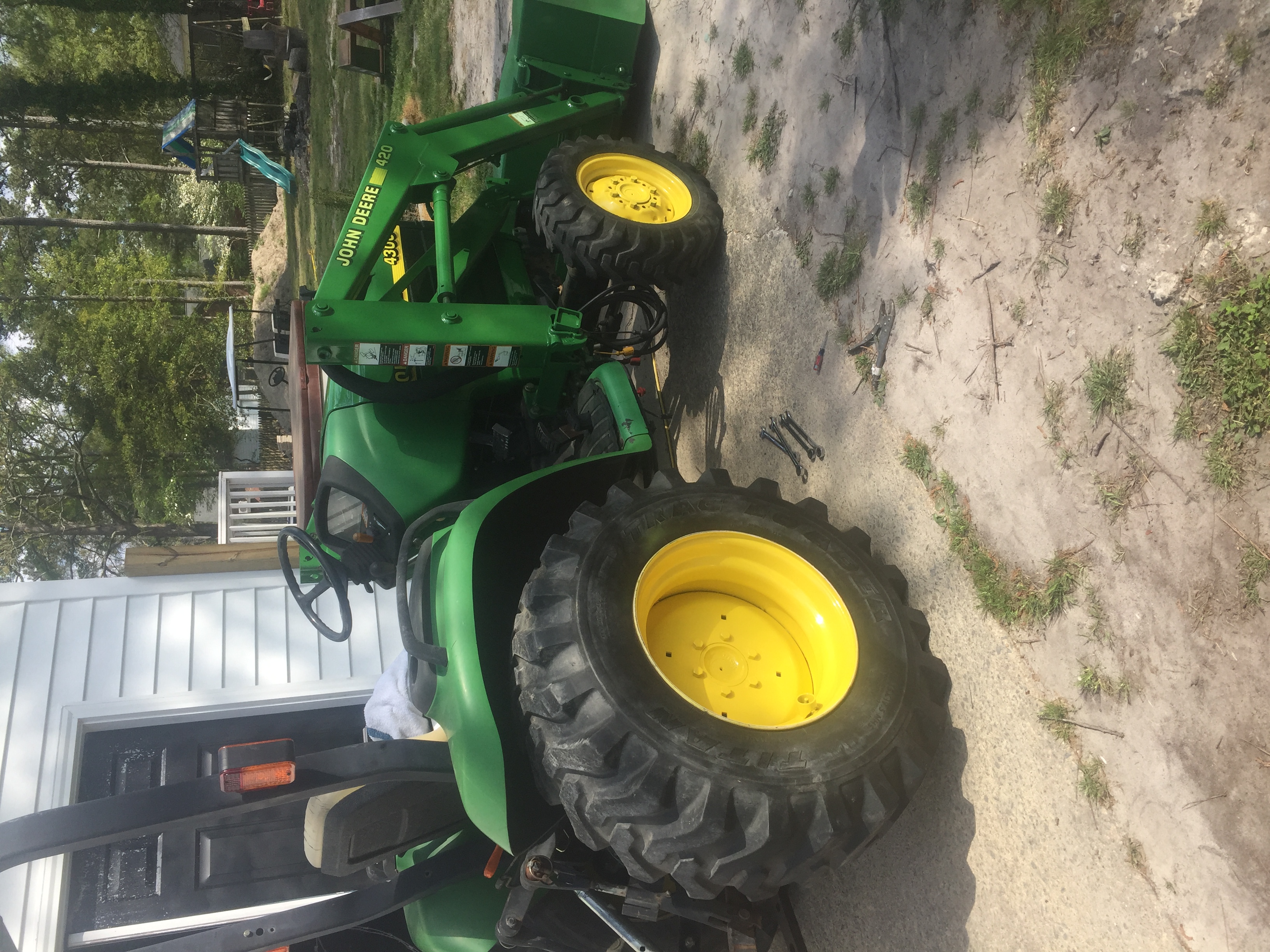

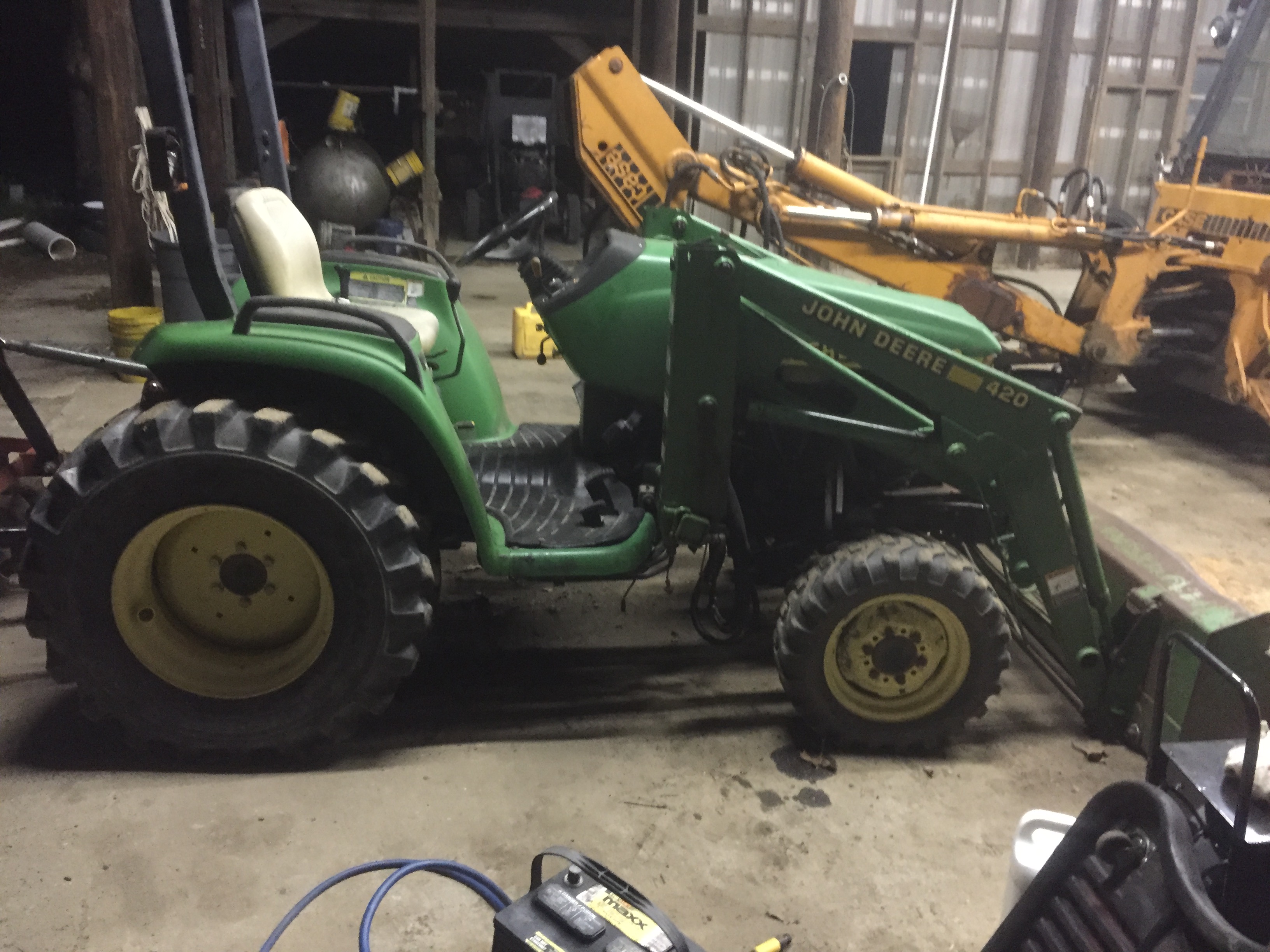

Hello all! As some might have read, I sold my Kubota BX24 and picked up a 2001 JD 4300. I finally have all the kinks worked out. Now doing some more maintenance things. I have a question...I had bought a bunch of Kubota Super UDT hydraulic fluid. I still have a bunch left over that I haven't been able to sell on Craigslist and the dealer won't take it back. I need to do a full drain and fill on the 4300....can I use this? Is this as good as the JD stuff? My 4300 is a HST.
A few before after pics too...
