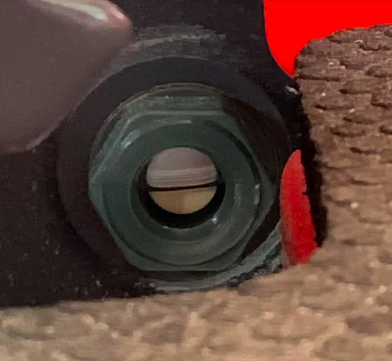

dumb question, but does this mean its below visible? i got paint on the glass and scratched it off today. i don't think this shows anything?
/ hydraulic fluid level sight glass #2
Looks low to me, if it's on level ground, and loader & 3 point are as low as they can go ...

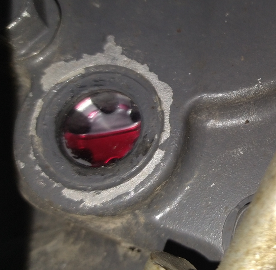

Move it so the back is lower than the front, you should see a slightly yellowish/orangy fluid in it, correct level will be halfway up the sight glass when parked on flat ground with loader and three point all the way down ...
This mine, I have red dye in mine ...
ETA - just snagged this picture from another post ... With the Kubota's fluid in it

i changed the filter and didn't add any fluid. guess i need to add some. the 3 point is all the way up when i took the photo but the FEL is all the way down.

The 3 point up or down doesn't make a big difference, just easier to check the level in a consistent way every time, so I do mine down ... My sight glass is on the back of the tractor, so less in my way ... Unless the backhoe is on!
A gallon of the Kubota SUDT fluid will be in the low $30's ... Add just a little at a time, and you will see it come up in the glass.

Yes, but this is cheaper in the long run, and what I actually used ... https://www.zoro.com/kingscote-dye-...red-4-oz-506250-r4/i/G5130815/#specifications ...
That picture was 6 drops per gallon of hydraulic fluid, but I only put 2 drops in now, put it in the jug of fluid, as it WILL stain your tractor and your fingers too!
This is the 2 drop per gallon on uneven ground, but shows how it can stain, when full strength!
