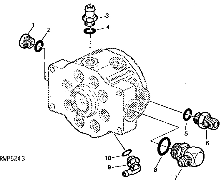

I have a 1977 john deere 2030 , Hydraulic fluid has started leaking out of the hydraulic pump vent line with engine off whats going on? This has just started ,haven't been using tractor much but loader is strong and power steering good, seems to be no problems ,pump was replaced in March 2015 also filter and fluid.

Look to see if pump drain line is pinched together(kinked).
   / hydraulic fluid leak
not sure how drain line connects ,does it go on small elbow on pump then back up to the reservoir?
   / hydraulic fluid leak #7
not sure how drain line connects,does it go on small elbow on pump then back up to the reservoir?
Yes that's correct line attaches to 90° elbow(parts key 9)

If it leaks, the line must be cracked. If it leaks while running, then the internal shaft seal could be bad. That line is there to relieve excess pressure from behind external seal to keep it from blowing out.
