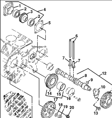

My guess is seal on hyd pump which mounts on frt LH of engine has failed. Hyd pump attaches to drive gear(key 1). From searching JD parts it appears they offer no seal or seal kit for pump. M810115 Hydraulic Pump - ADD 729.64 USD

Dealer repair tech ran his diagnostics and concluded the problem was with the hydraulic pump.. no surprise. Their solution was to r and r the pump and quoted way to much money. So instead i go them to order me the two gaskets that seal the pump to the gear housing and an oring that fits over the intake port.
When i got it home I took the pump off without problems. Didnt' have to remove any other parts to get it off either. Took the pump apart completely. it's a surprisingly simply design actually with a single shaft driven gear on the inside which meshes with another idler gear through which the fluid flows. I learned that its an 'open centre' system, meaning fluid flows through it continuously and it's direct drive off the cam. i inspected the few parts comprising the pump and everything was pretty much in tact with no signs of wear or damage, no signs of wear on the bushings holding the gears in place either.. generally it all looked in pretty good shape. The service manual helped a little but honestly i didn't even have to look at it to get it apart and put it back together. I took my time paid close attention to how things reassembled and made sure i took note of which position the internal plates wedged against the internal gears were supposed to be in. From when I started taking it apart to when i had it reinstalled, Id say it took maybe 2.5 hrs. I'm completely mystified by why the dealer charged so much for labour (?).
After getting it together and changing all the fluids, i took it out for a boot, did some loader work, cut the grass about 4 acres, and inspected the engine oil level frequently. So far so good..touch wood. All in all, i'm relieved the pump was serviceable and not too difficult to do. I took a few pictures throughout the process if anyone would like to see em.. lemme know and i can post em.

On the gear pumps, the fluid flows around the gears not between the gears. Usually what happens when the pump wears is the fluid gets between the side of the gears allowing the pressure to flow towards the shaft blowing out the seals. I would start saving up some coins for a new pump in the near future.
