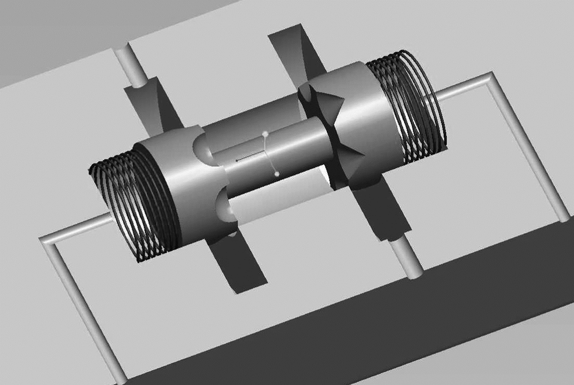

When I mentioned a metered valve, what I had in mind was something like this that has the notches in the spool where a small lever movement would start allowing fluid to flow via the notch. And the farther it was pulled, the more fluid would flow.
Instead of a separate valve in-line that would have to be adjusted each time. The cost seems to be only a few dollars per spool. I've seen the fittings with the .03" hole, but don't know where to find them. Not even sure what they're called so don't know what to search for.

That looks like a normal spool valve to me??
Edit: I found where your image came from. A research article analyzing different spool shapes/grooves and ports in the valve body.
Analysis and Synthesis of Spool Valves With Arbitrary Metering Area Variation | Journal of Dynamic Systems, Measurement, and Control | ASME DC
I don't know if tractor/implement OEMs typically advertise the shape of the spools in their valves, so some may have notches while others may not. I think of a metering valve as something like this:
