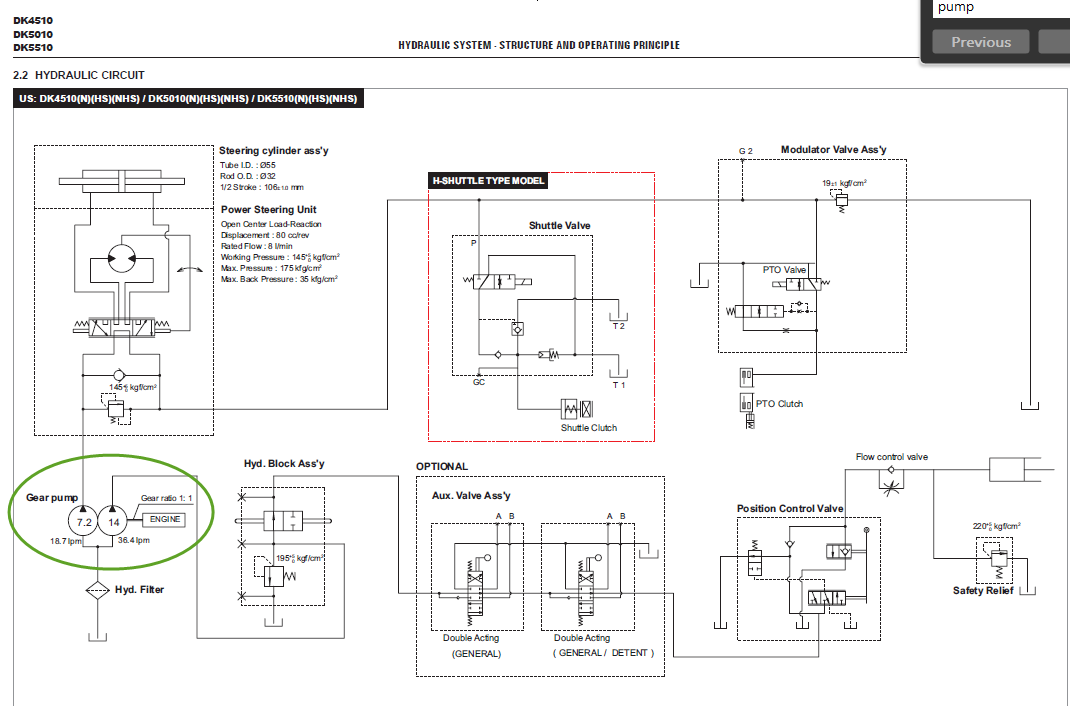

My tractor is rated at 11.34gpm at the pump. Im sure there is some loss through friction and whatnot. Does anyone have any idea if there's a rule of thumb as to how many gpm is available at the 3rd function valve? I do have a HST. The attachment I am looking at requires 7gpm and it is loader mounted. Thank you

My Kioti CK4010 has 11.7 GPM hydraulic pump flow, and 2.3 GPM is shared to the power steering. That leaves 9.4 GPM for attachment and implement hydraulics. The HST and 3pt hydraulics is run as a different system, and has its own dedicated hydraulic filter.

Rademamj1, how did you find the info on the amount of flow shared to the power steering? I am trying to compare various makes and models, but Kioti just lists the total pump capacity.

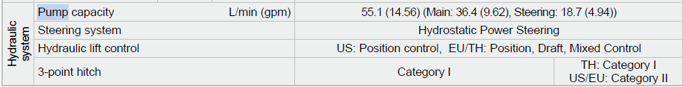

DK4510 Operator Manual:
Shop Manual:
In typical Kioti fashion, the Operating manual and shop manual do not agree (at least in gpm conversion).
