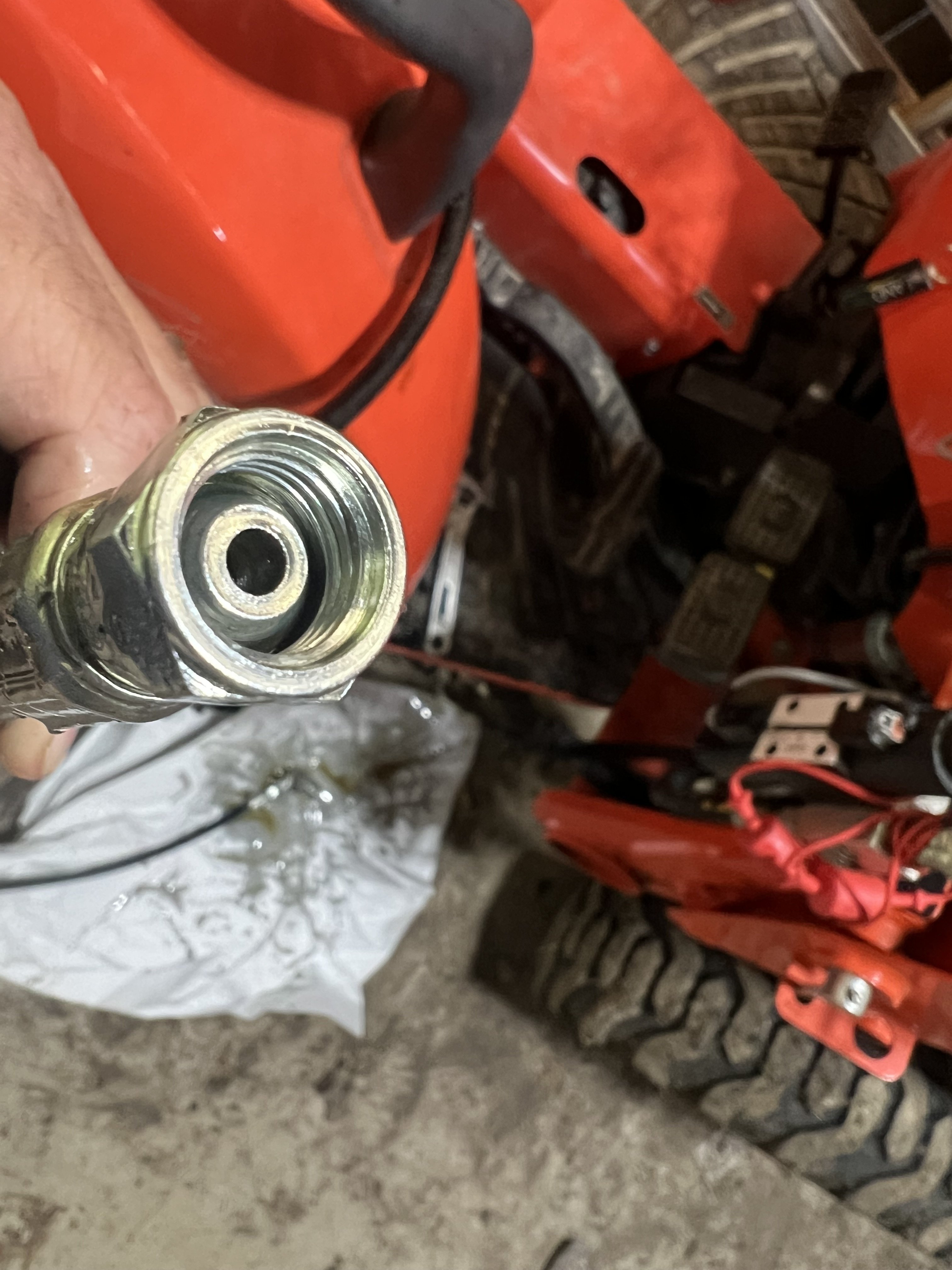

I bought a used Enrossie Sickle bar with Hydraulic lift. I need to change one of the hoses to make it fit the tractor properly (too long). I ordered what I thought were the right fittings but the fitting on the end of the flow control valve is not like I am used to. NPT or JIC is what I had assumed were used. This has a round nubbin and socket. What is it and what do I need to ask for?
   / Hydraulic fitting for Enrossi Sickle bar #2
I believe that is a pipe swivel end on the hose. Mating fitting must have taper to seal on mating taper in the hose end.
Suggest try threading a known size npt fitting to confirm this though.

Would this be a considered a "light DIN" fitting?
   / Hydraulic fitting for Enrossi Sickle bar #4
Looks like -6 npt
   / Hydraulic fitting for Enrossi Sickle bar #6
To me that's either 1/4" or 3/8" BSPP. That seems to be a 60 taper inside.
You are 100% - it is a NPT swivel fitting. I'd never heard or seen it before. NPT was always just thread interference fit seal to me - Still learning every day!
Thank you!
   / Hydraulic fitting for Enrossi Sickle bar #10
Thank you!
Glad you have it figured out and agree there are way to many fitting options these days.
Hopefully you are not like me where learn something new but forget half dozen other things😁
