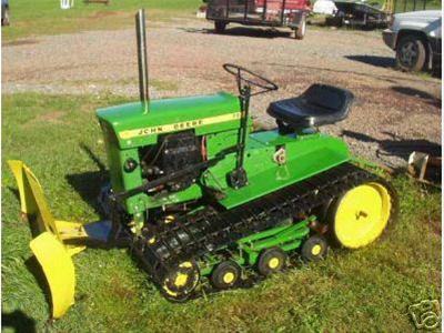

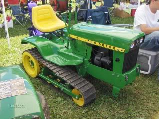

He wants to use an 18 HP engine he already has, but that is not really enough HP in my opinion.
His 18 HP at 3600 rpm can only power a pump, .7 cu in, pumping about 9 GPM at 3000 psi.
Could do something like this or better.
