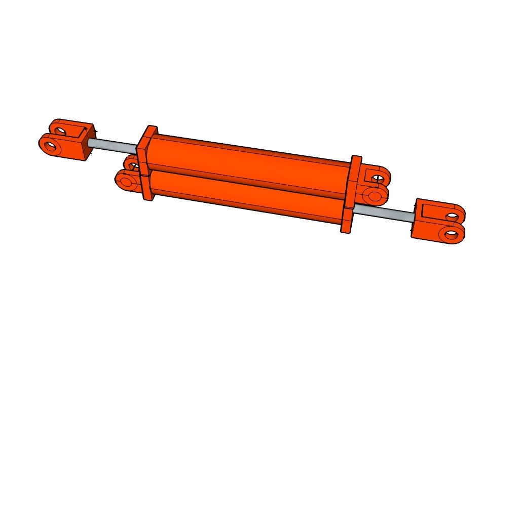

Have you guys any information on placing two double acting cylinders together side by side? I can't seem to find a reference on the Web.
I'm thinking of a concept where two cylinders welded together side by side with the rod ends at opposite ends.
This could in theory allow a shorter package when compressed that would extend double the normal length when pressurized out.
Using this in a top link configuration is my main reason for this so far.
Any information, tips, comments, or ideas are welcomed.

I'm not the first to come up with this. here's a sketch from a thread on TBN in 2009!

Looks like that would put the rods in a bending moment. Interesting idea for a top link, though.
As I've been armchair surfing looking for this thing, I've found the name for what I describe.
These are called piggyback cylinders.

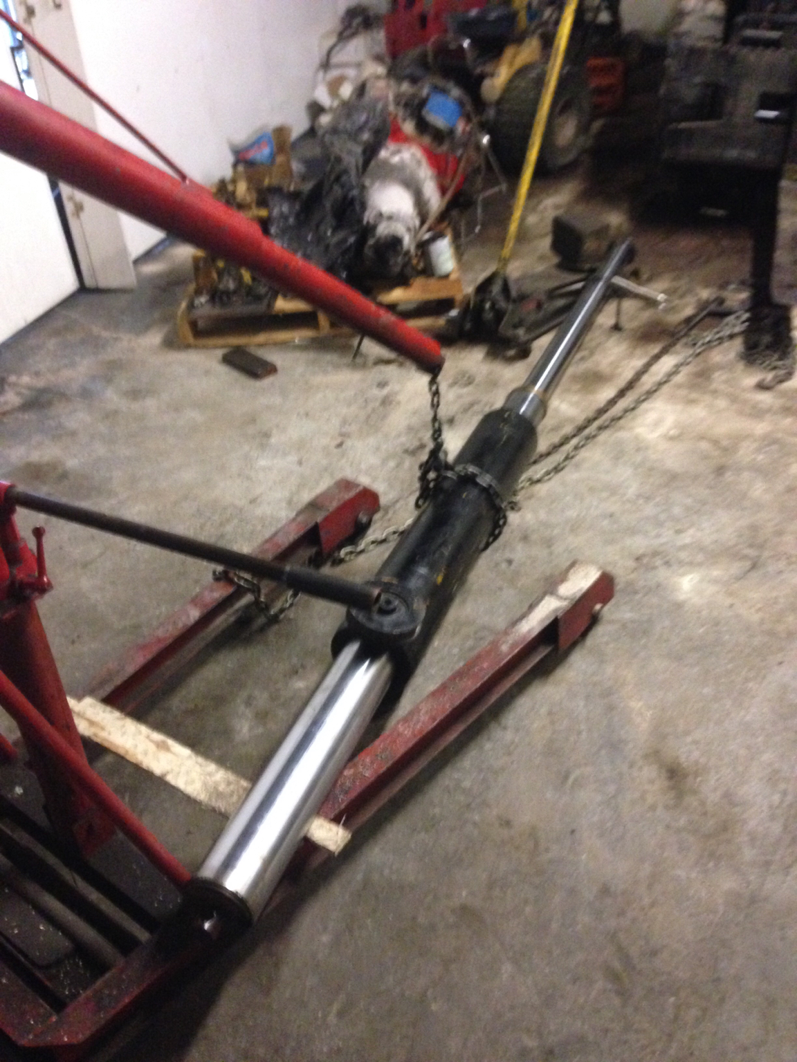

Because that’s not in the capabilities of a home shop fabrication job. And it doesn’t have full strength the whole stroke where a piggy backed cylinder would. I’ve seen forklifts with piggy backed cylinders and telescoping cylinder. The piggy backed ones are small and in comparison cheap cylinders. I’d bet the 4 step telescoping cylinder in my Cat cost more than I’ve got in the whole forklift. Not to mention it’s a real PITA to work on. IMG_7372.JPG

Because that’s not in the capabilities of a home shop fabrication job. And it doesn’t have full strength the whole stroke where a piggy backed cylinder would. I’ve seen forklifts with piggy backed cylinders and telescoping cylinder. The piggy backed ones are small and in comparison cheap cylinders. I’d bet the 4 step telescoping cylinder in my Cat cost more than I’ve got in the whole forklift. Not to mention it’s a real PITA to work on. View attachment 538939
It is well within the capabilities of my home shop and skills, but that is different from person to person. Perfectly functional cylinders in different configurations can be found for cheap if you do some looking at scrap yards and such. Was just trying to point out some other possibilities.

As has been mentioned the issue with that piggyback design is a potential for side loading the rods. You cannot simply pin the two rod end clevis as you would a normal cylinder. You must restrain the body in a way that keeps it parallel with the rods but allows it to slide, complicating the design a little bit. I've seen rods bend when the side forces were not properly accounted for, but at the very least the packing and rod would wear poorly.
Hmmm... something to think about.
My first thought is the cylinders would be more or less self aligning to the rods on each end in a piggy back configuration if they were placed vertically on top of each other.
And actually be stronger than a toplink. And we are told not to back up under power to dig, scoop, etc to avoid bending lift arms so this is for a pulling scenario mostly.
Lots of good information here. I had thought of a telescoping cylinder but as noted, they are heavy, expensive, and I didn't find one that would work in a toplink scenario.
I agree also with the fact that I can piggyback 2 cylinders in my shop fairly simply with welder and drill press being the major tools required.
I have thought of getting 2 cylinders.
Maybe 12" in length. With the square base ends on each end. Weld the ends together. Or possibly a plate that both would push against with a slot cut out for the one rod coming out on each end of the assembly.
If this worked, I'd get approximately 13-16" length that would extend to 32-36".
If I could find cylinders with bolt holes in each end plate perpendicular to the rod, I could stack the cylinders, drop bolts/all thread down through both and that would be four bolts to hold the side forces during extension.
Do you guys think a 1" rod would be enough? Or step up to 2"?
For a 30 hp tractor, the smallest that would work would keep the weight down of the assembly.
A class 1 toplink has a 1 1/8" threaded rod I believe.
