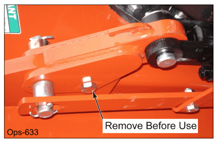

I have to offer a correction / retraction about travel of the wing cylinders as the wings flex up and down. Many, perhaps most batwing mowers have some sort of mechanical flexure mount for the rod end of the single acting lift cylinder (double acting cylinders can be had but I still don't see the benefit)
The Rhino FR-15 I have has mechanical flexure mounts like I've shown in the picture attached. They are pretty robust. Newer models just use slots I have never observed them to move but I'm sure they probably do as I get in the ditches and on pond banks and such.
