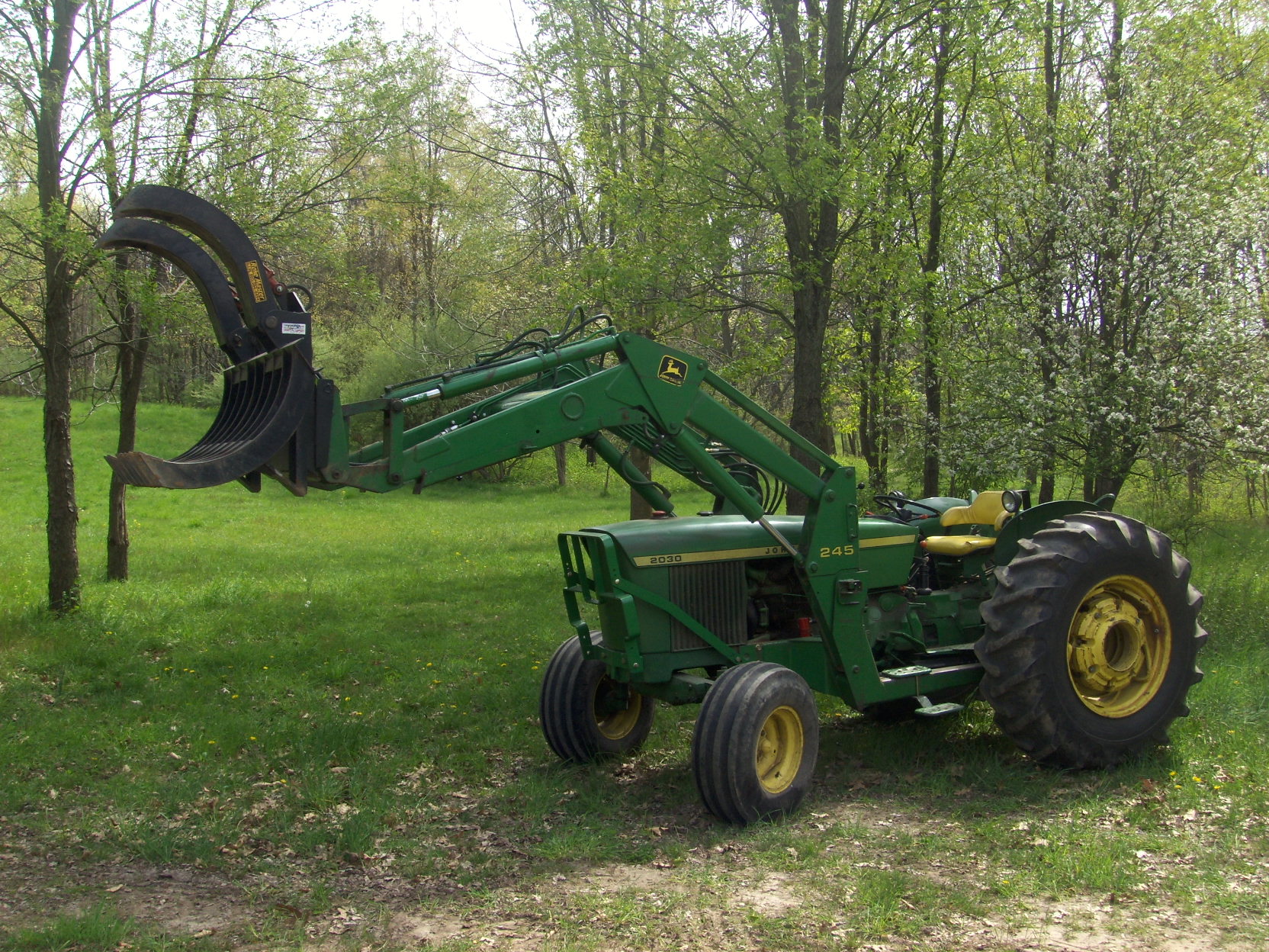

Oh wow, I've never seen that site before.
I realized now I need to pick a cylinder first as they don't seem to be 100% universal.
Any suggestions for a cylinder to base my grapple design around?
I don't know what diameter or stroke is commonly used.
ac
The cylinders on my grapple are 2 1/2" with 8" stroke.

Use a cylinder meeting ASAE dimensional standards. Most grapples do, and you are assured of always finding cheap, commonly available replacements.
   / Hydraulic Cylinder Drawing/CAD Model?
You know, I had wondered if there was some sort of standard for exactly this reason.
Any links to an example?
