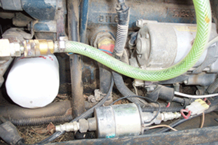

I have a heater for my cab that I take out every spring and install every fall. Would it be possible to use hydraulic quick connetors adapted to the cooling system and heater so the heater could be removed without removing hose clamps and plugging the ends.I have a ball valve on the line to shut down the circulation when its not in use. Does anybody have any experience with this or some other ideas I could consider.??

I use air line connectors for the heater hoses for my cab. When my cab is removed, I just short circuit the water line as shown in the attached photo. When I have the cab on, I attach the supply end to the input side of the in-line fuel pump visible at the bottom of the photo. The supply hose to the cab attaches to the output end of the pump and the return hose from the cab attaches to the lower hose connection. The in-line pump eliminates the need to bleed the air out of the circuit to the cab. There is minimal fluid loss when changing over either way. I think valved connecturs such as hydaulic fittings might be too restrictive for heater hose connections, ie not enough pressure to get an adequate flow. /forums/images/graemlins/smile.gif

Have you considered just making an auxillary route? By this I mean a couple of tees & valves & you could leave it hooked up all the time, but just turn the valves to have it flow or not flow.
All you would really need is 2 valves. You wouldn't have to restrict both sides of the heater, just one to stop/start flow & one on the auxillary route to start/stop its flow as well.

I remove the cab and standalone heater every spring and let the heater hoses attached to the tractor with plugs in the end. I was looking for a way to remove the heater without undoing 2 hose clamps and plugging the ends.
