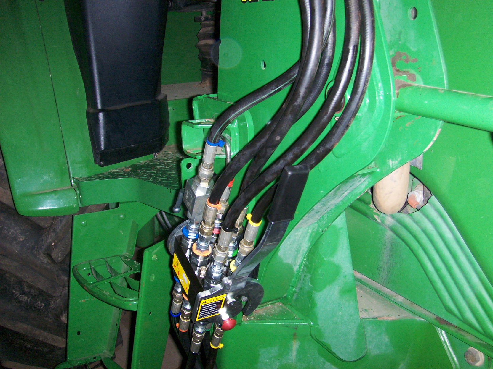

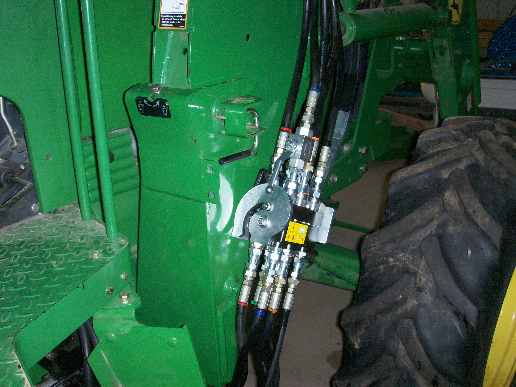

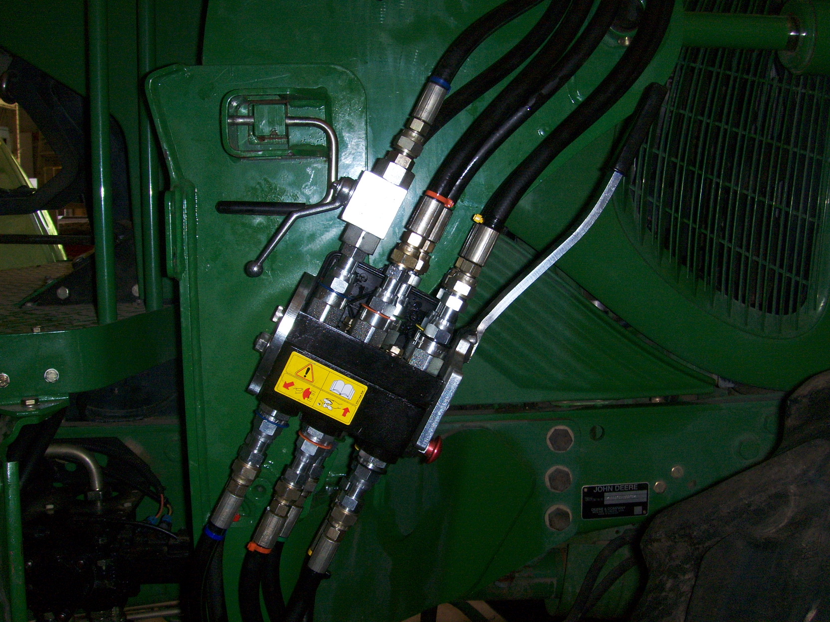

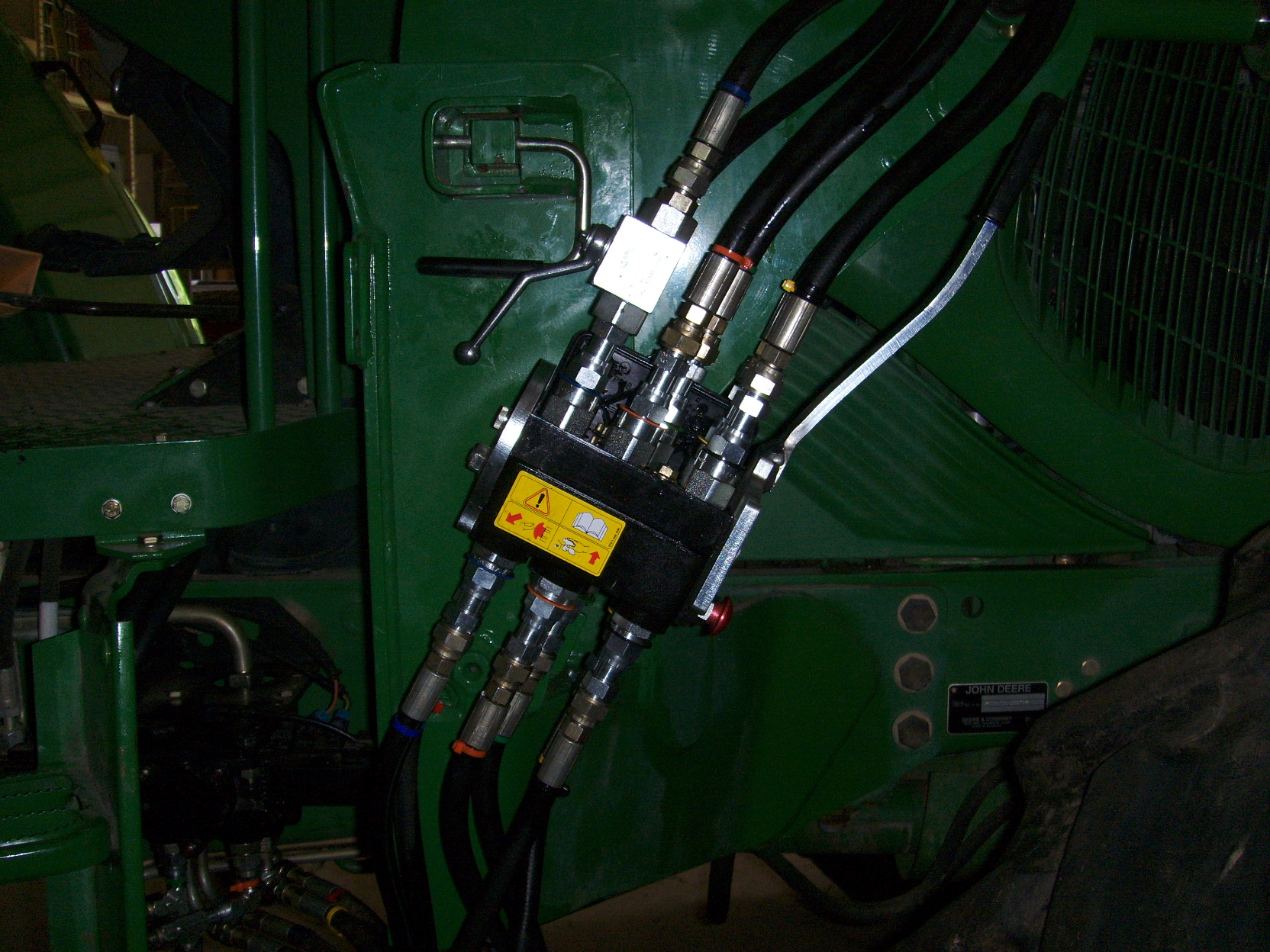

Get a multicoupler made by Faster. It's what JD uses as OEM. I swapped one onto my JD 6415. Best money spent.
