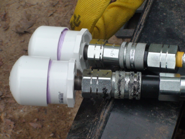

As others have mentioned, a standard problem with temperature changes and fluid/pressure expansion in the lines during storage. This is what fixed my problem with reinstalling the fittings after implement storage. Simply attach mating connectors to PVC caps that have a tiny hole drilled in them to relieve any pressure build up. Adding a small rag in the caps before assembly can help with fluid seepage, if any.
As far as removing/reinstalling fittings during usage, as mentioned, just move the hydraulic control handle(s) to bleed pressure while the engine is not running.
Also: How To Depressurize Your Hydraulic System On Your Attachments For Easy Reconnect - YouTube
They also make QDs that can be connected/disconnected under some amount of moderate pressure, which I have added to my hydraulics, but I do not recall the type.
