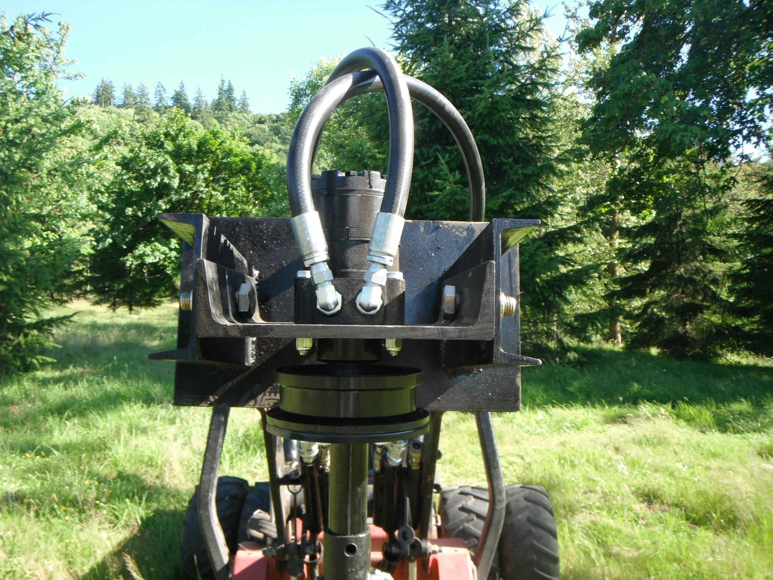

Here is a hyd auger that one of the PT owners made .
It is a wheel motor adapted to whatever that is.

This auger from Land Pride is an 8 cu in hyd motor and requires about 10 GPM.
HD25 Series Post Hole Diggers | Land Pride
8 cu in and 2500 psi = 3185 in lbs of torque, and 10 GPM = 289 rpm max.
You can run this auger at any rpm.
