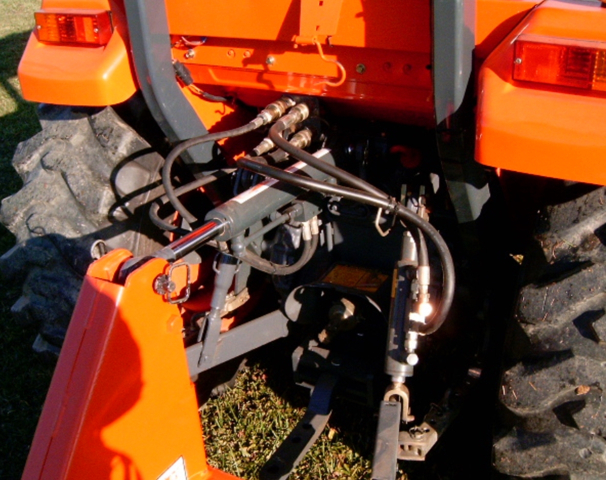

Why can't a banjo fitting be crimped onto a hose?
I'm fairly sure that one of my BH hoses has a banjo fitting on the end of it ...
Or maybe build a shield over the "crush zone" to protect that area from future catastrophe's?
The Banjo Fittings can be crimped onto a hose. I have fitting sets for 1/4" and 3/8" for 100R2 hose that came with the bolt and washers for each one. I have the crimp sleeves too but I don't like them. I have a line on better ones but they're twice the price. And I don't need them for now.
The Problem is the other end of the hose. 🤷‍♂️

The link that @ptsg gave has the hard tube. The Compression nut and ring would be optional if yours is still good. I think I'll order a couple of spare parts to keep on hand. My tilt cylinder had a similar "accident" before I made room for it. I've ordered from them before.
Edit: I only saw one tube. Make sure it's long enough.

The main problem is I had ROPs down and lifting back blade bent the top link 1/2" O.D. pipe on it (third time I've done that!). Will this Surplus Center kit work?
If I mount link upside down hoses won't reach. Any ideas how to protect/prevent it from happening?
First thought would be to keep the ROP up. If you were going to do that incident #2 & 3 wouldn't have happened though.
I have never seen a live armadillo laying on it's back, probably because they are so vulnerable in that position, what if you just turned your link upside down and put the delicate parts where you can't smash them? Longer hoses once or continued repairs? You might just be able to change straight fittings to 90's or 180's and use the same hoses.
