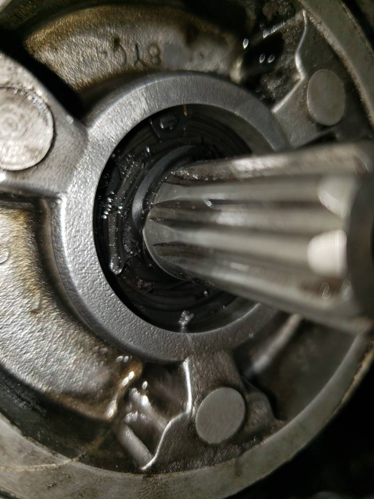

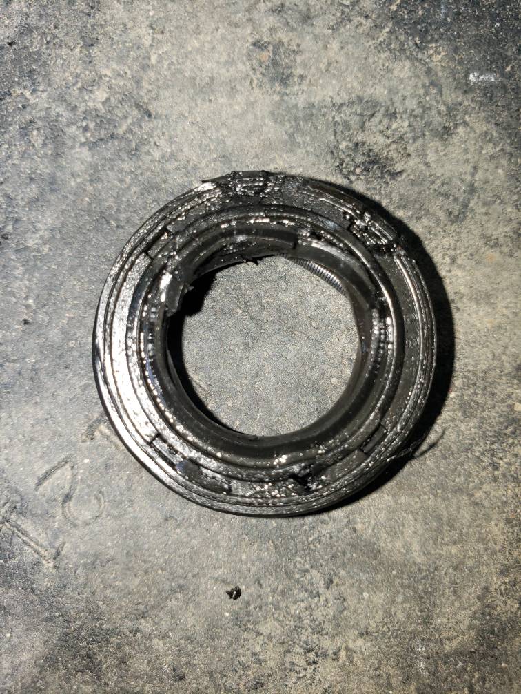

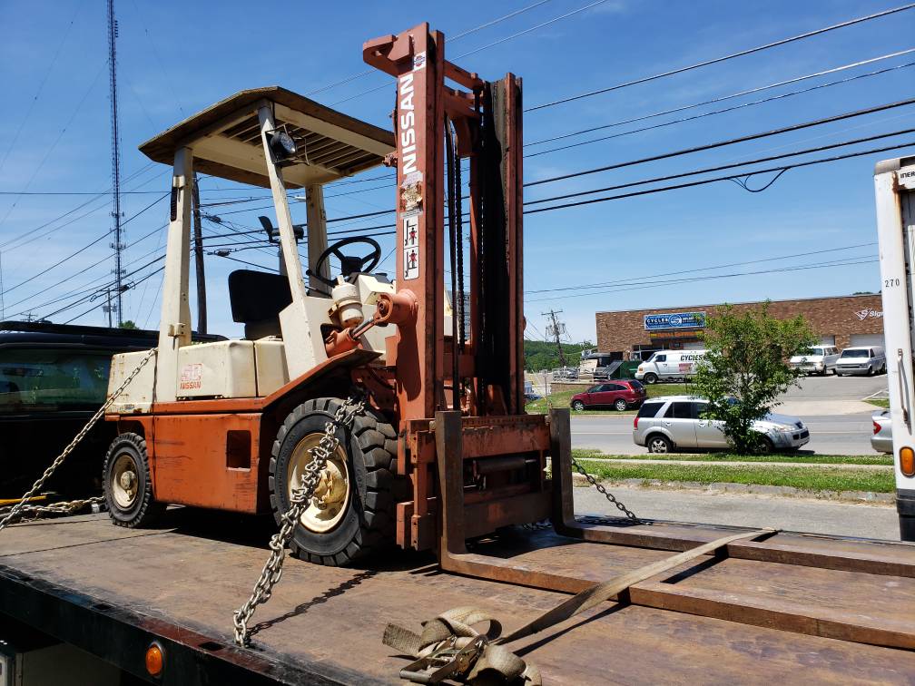

I recently purchased a Nissan forklift, was able to get a good deal due to hyd. fluid entering the crankcase. I pulled the pump off and sure enough the front shaft seal lip was partly flipped over, I am going to pull the pump appart to inspect to see if the overpressure at the front shaft is due to wear or some other cause like a bad Internal seal or clogged drainback passage.
So far I havent been able to find any parts for the pump or even the shaft seal, unfortunately the numbers on the seal got damaged during the removal so I only have a partial number and haven't been able to cross it. Being the day before a holiday I couldn't get ahold of a few online suppliers, out local industrial supply house couldn't match the seal and the local hydraulics shop closed down a number of years ago.

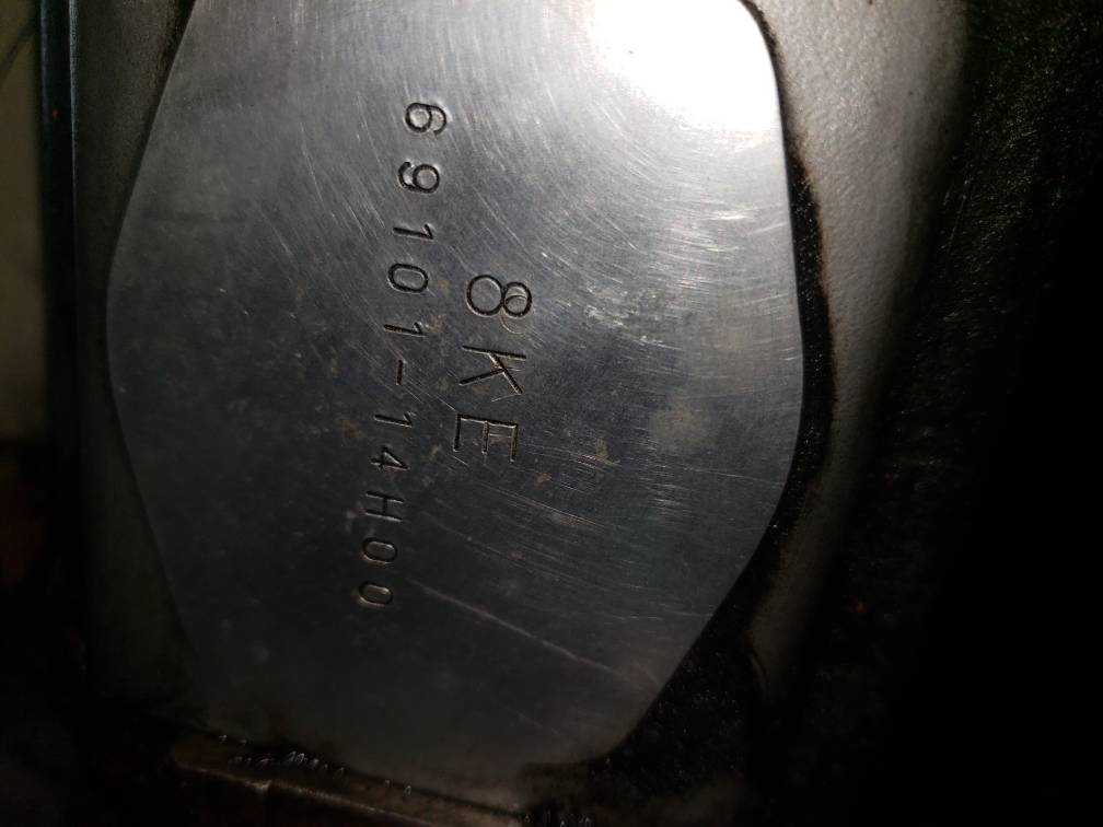

Pump numbers are 69101-14H00, I also found a affordable NOS 69101-04H00v pump but without knowing the number breakdown it's hard to say what the difference might be.

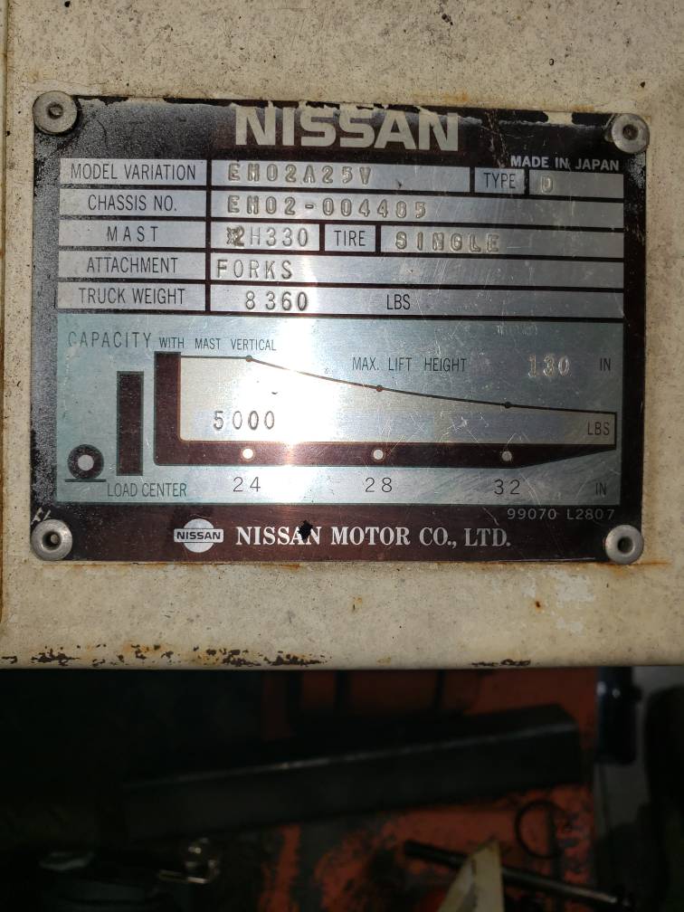

I included some pics of the pump numbers and forklift ID plate. 20190702_185922.jpeg20190702_181448.jpeg20190702_173728.jpeg20190702_174853.jpeg20190701_122940.jpeg

Well after hours and hours of searching I found a seal in a Timken catalog that should work, of course nobody stocks it so I have to order it and wait to see.
In the meantime I pulled the pump appart and found a failed seal internally that caused the shaft seal failure.

Got the pump put back together and seems to be working fine. Unfortunately the front seal that came in the kit was for the larger shaft pump. Since the shaft had some light grooving I decided to just machine and harden a wear sleeve/space and press it together with some loctite 640, turned out well.
Also had to open up the seals bore on the front of the pump .065" for the new seal.
