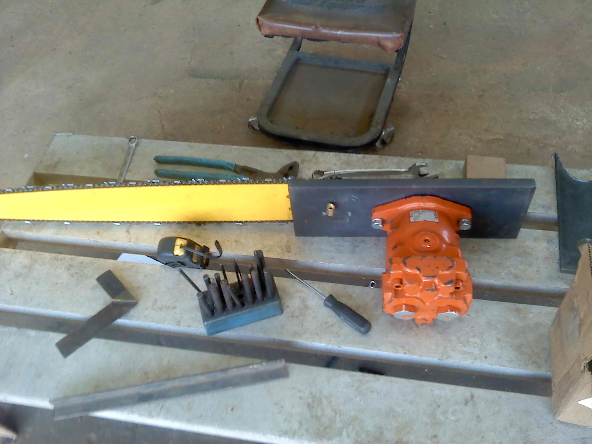

I have a rexroth hyd motor I need some more info on. There are 3 numbers on the tag attached to this motor.
codice#7.003210001
serial# 1301569 028
data# w2311
Info I need is cuin displacment, max flow, max psi, and max rpms.

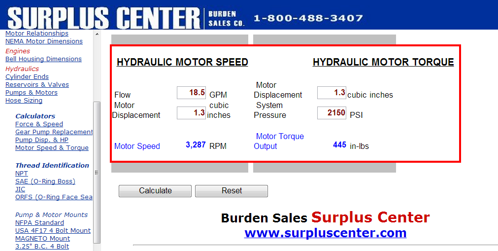

I know this motor will run 3150rpms at 2150psi and 18.5gpm. This suggests a 1.3cuin motor. I have been told, but havent be able to verify, that this motor would run at 4800rpms at around 30gpm which are the numbers I am shooting for. I just hate to go thru the build process and findout my info is wrong at the end of the project. Any help would be appreciated.
/ Hyd motor ID #2

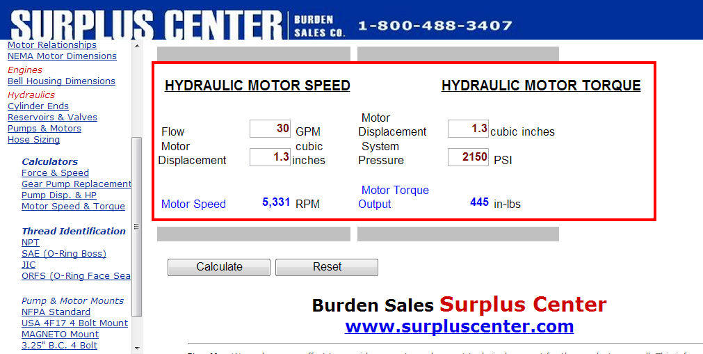

30 GPM would run the 1.3 cu in motor at 5331 rpm.
Where did you get the pressure limit from?

JJ, this motor is used on a vibrating assembly. The numbers posted came from the schmatics for the equipment. I am wanting to use the motor to run a hydraulic chainsaw. I dont believe the numbers I posted are the lmits for this motor, just what it is speced for the particular assembly it came off of. I am trying to find out what those limits really are.

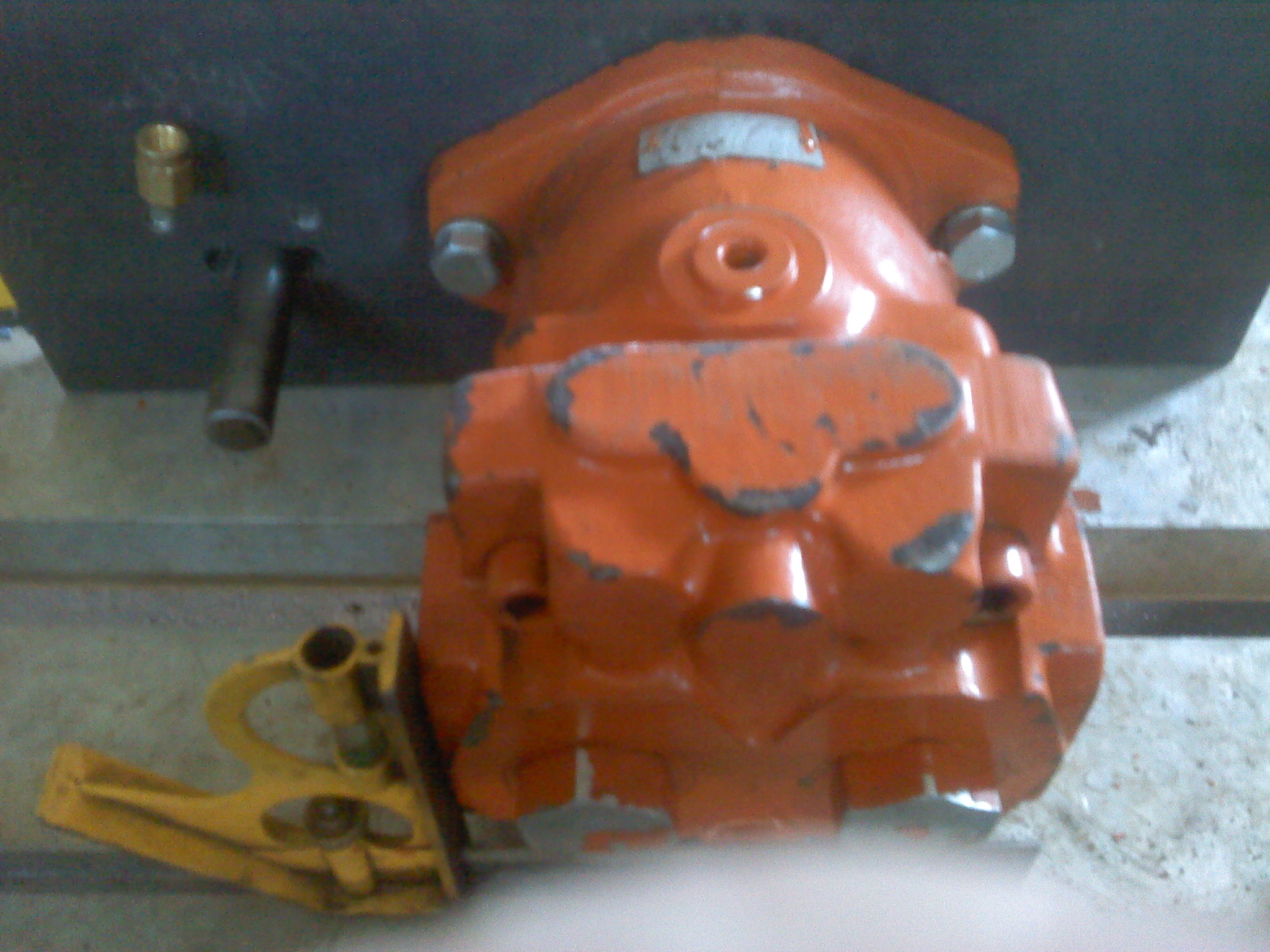

I am suspect as to displacment. This motor is a bmount and weighs probably 25lbs, with #12jic ports and a casedrain. The numbers came off a tag attached to motor. It is, or should be, a rexroth, but it is a special application motor. I havent been able to find anything using those numbers either. I suspect the equipment manufacturer could have attached their own tag to the motor, but those folks wont tell me anything about the motor. Sell me a new one they will, but I guess they are afraid someone might try to find a cheaper replacement instead of buying one from them if they give out to much information.
/ Hyd motor ID #7
Can you post a picture of the motor. Some times a picture is worth 100 posts. This may be one of the older Rexroth gear motors that they sold to some one. I want to say Haldex Barnes but not sure. I think they were made in either North or South Carolina. Just looking in one of my old books and the 1.28 cubic inch that had an SAE B mount & had #12 SAE ports. Those models all stated with PF in the model code and were good to 3600 PSI.

This pump is 5 1/4in wide and 7 1/2in long
/ Hyd motor ID #9
That looks like an axial piston motor. Possibly A10F* series. If you remove the SAE plug show in the top middle of the motor do you see a rotating group consisting of the cylinder and some pistons. If you remove the work port plugs you should see some kidney shaped ports that feed the pistons.

You can figure displacement on these by turning it into a pump. Connect a line to one of the work ports. Place the other end of this line into a container of oil. It works best if this container is even with or above the motor inlet. Rotate the shaft 10 turns and measure how much oil you have have pumped. Divide this by 10 and have displacement per revolution.
