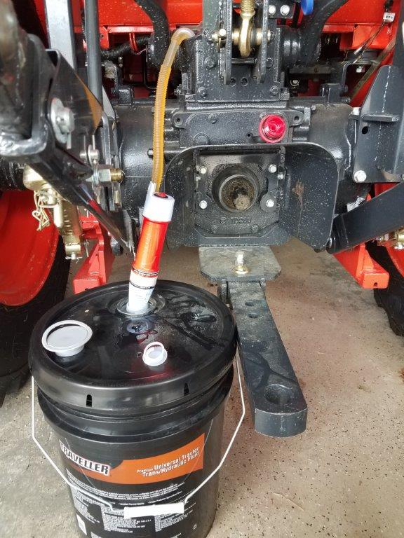

Coming up on my 50 hour service on my Kioti DK4510 I was going to use 5 gal buckets as well, but after reading this I was reminded that I have a bunch of those storage bins that should work the same. A slight variation though, I bought an inexpensive battery operated transfer pump from Harbor Freight to (possibly) pump out most hydro fluid from the top, swap filter with minimal loss, use same pump to put it back in and top off as needed. I will likely be posting soon on one of two other forums... Harbor Freight Tools That Suck or Harbor Freight Tools That Don't Suck...
Well, trying to figure out which forum to post it to. It sucked some but not entirely. It worked but wasn't near as fast as advertised.
Was unable to pump out from top so I drained it to a 66 quart bin from Lowes.
I was originally going to reuse the oil but didn't like the looks of it in the clear bin, so I bought some Traveller's Universal Tractor fluid. I used the pump to transfer the new Hydro/Trans fluid from the 5 gal pails into the tractor, then from the plastic bin back into the buckets for recycling. It worked, but was fairly slow. It was better than trying tohold the 5 gal pails over a funnel. The pump is probably better suited for lower viscosity liquids like gasoline or diesel fuel.
There is a different pump I will try next time.

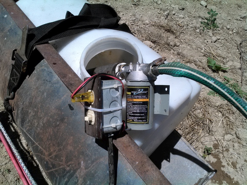

Amazon has similar pumps with automatic shutoff. There's a float at the end of the output hose. Be sure it runs on 2 D cells or more, because power is marginal for higher viscosity fluids.
I used this to pump used UTF out of a big plastic storage bin into 5 gallon buckets for recycle. Very slow, but it worked. I finally put the bin on a little platform to pump downhill, this helped. Overall, far easier than trying to tip that storage bin into a funnel. Slow but no mess!
I use this to refuel the tractors from the 5 gallon jugs (and old UTF buckets with lid intact) that I use for fuel transport. I can also pump fuel out of one tractor for use in another if I don't want to go buy fuel. The automatic shutoff is very handy, recommended.
I then bought a cheap one to transfer drinking water from 6 gallon camp jugs into gallon bottles. This runs on AA batteries. Not recommended, it's slow pumping water. And it wasn't until page three of the manual that I found 'Do Not Use For Drinking Water'. That's not in the Amazon description or labelled on the box.
As for the 12 volt 290 gallon/hour pump - that could get real exciting at 5 gallons per minute. Maybe rig it where you can step on the cable and pull a plug out of a socket to disconnect the power quickly.
Those have a warning against volatile fuel. UTF and hydraulic fluid might be ok, I don't know.

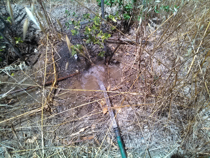

Here's an application of that 12 volt pump for watering. Output is comparable to a garden hose.
kimg0683rhfpump1-jpg.430355
kimg0685rhfpump2-jpg.430356
(But a year later to deliver more water per trip to 100+ new orchard trees, I replaced this with a sump pump in an IBC tote).
