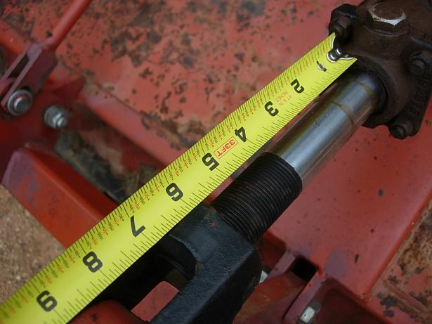

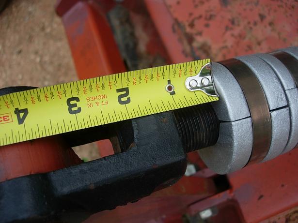

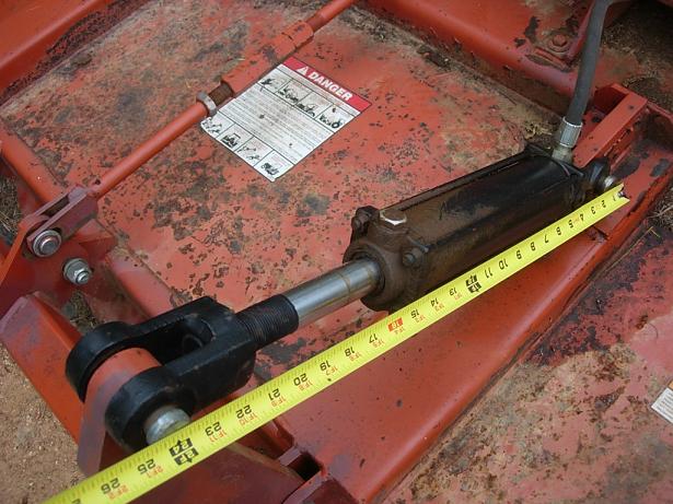

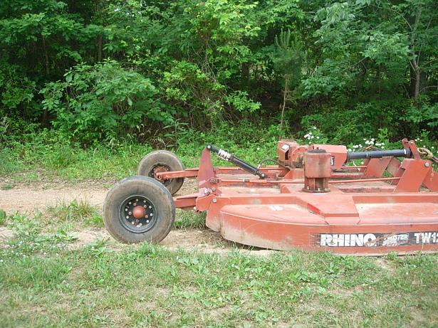

Here's picture of mower. The first picture is with the wheels fully raised (deck is on ground). What I find interesting is even AFTER doing that and inserting the cylinder clips, I STILL have about an inch of extra rod open to me. Do I just slap MORE clips on it or do I need a shorter rod? As it is, the clips are starting to get into the threaded area of the rod. I'll admit that doesn't bother me a WHOLE bunch.
Picture 2, the Rod fully compressed (fully defined as only by weight of mower driving it down) is about 24" eye to eye
Picture 3 shows just under 6" of open rod with mower in lowest position.
Picture 4 shows about an inch of threads exposed and if I put more clips on I"d fear they'd booger up the threads.
Makes me wonder if this is the stock cylinder?
Fully extended it's about 28" so there seems to be about a 4" stroke between mower on ground and fully raised.
Since we've deduced that the cylinder is leaking some (by the oil squirting out when raising mower) I don't mind getting that fixed. I ALSO don't mind simply leaving it as is using the clips to hold the weight of the mower when cutting and use the cylinder to raise it only when necessary.
I of course, do not know if there is anything "wrong" with that logic which is why I'm putting it here.

If it was mine, I would probably look on the Rhino website and see if they have specs on the cylinder for that mower. If they did not I would call and ask.
Looks to me an awful lot like a cylinder I could pick up at TSC etc... I doubt I would fool with rebuilding one as cheap as they are new.
It would not bother me at all to put the blocks over the threads.
After looking at it again, could you not just screw that upper clevis in a bunch (at least till it came close to hitting the arm) and thereby reduce the amount of exposed thread, and inherintly the amount of spacer's needed, or would that make it not extend / raise enough?

Welp, it does seem that's not the stock cylinder. I just hung up with their technical help people and he informed me the stock cylinder is a 2 1/2" x 8" cylinder with an 8" stroke.
he also went on to tell me that I really REALLY need to replace one of the bolts that hold the gearbox on. For some reason, it's sheared (probably when ever they hit what ever they hit that caused the other issues)
So, now that I know the seriousness of that bolt, I'll make sure I replace it prior to using the machine.

I keep the height on my 15' batwing mower supported by the spacers. I feel that it takes a strain off the cylinder, but my real reason is for going back to the original height after lifting up slightly to avoid a scalping area.
Looks like you just a need a few more. Remember, they are only loaded in compression, and the only damage to the threaded part would be when the spacers are rattling around loose, and would seem to be insignificant. A split pvc pipe or some spiral wrap, maybe, if it seems to be a problem?

It does look like a TSC cyl to me.
I would thread the rod into the yoke as far as i could.
I wouldn't hesitate to put those soft cast (cr@p) metal spacers on my hard metal rod.. the spacers are likely to wear before the threads do.
On my jd 1517 batwing, there is about 1/2" of threads after my yokes showing.. I set a spacer on em.. mower is a 98 and has seen heavy mowing in its lifetime.. threads look new.. spacers are wore out!
