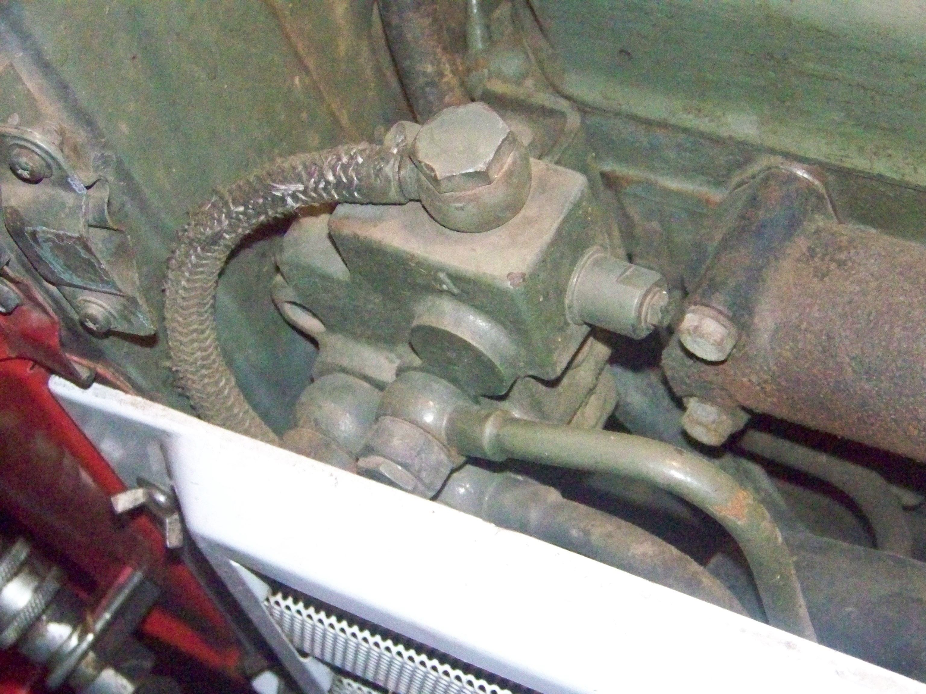

There is a spring and a ball bearing and then a shaft inside behind that big nut. The spring is not powerful and as long as your aware that it will come out when that last thread on the nut comes off you can easily hold it without any real effort and then just ease it apart watching how the pieces come out. I had a part fall out of mine when I took it apart cause I was in a hurry and could not figure what was wrong, I think I had the shaft thing or something in backwards. I pulled it apart several times thinking the oring was cut and I kept swapping them and looking, the diagram was not clear enough for me, finially I figured it out and swapped it around and got it back working right. Yes I did drop a piece, but I didn't know what was in there and I was rushing taking it apart, but each subsequent time when I pulled it apart there was not problem or remotely close to loosening a piece cause I was ready for it.

Winston, I will see if I can check this relief. It appears to be located under the big knob. I don't really know what I would / should be looking for in the relief to determine if something is wrong there ,or not

Relief valve could have trash in it or a broken spring. Probably not, just thinking how fast you are leaking down sounds a little unusual for a control valve to leak that bad. Also, costs nothing to check.
Another edit. Going back to your first post stating high rpms to have loader function sure sounds like pump is going bad or suction stopped up. Your 3 point relief valve is down stream from your loader. But then again, the 3 point should not leak down that fast. Did this all happen pretty suddenly or over a long period of time?

winston, My system doesn't have the B like in the link you posted. I assume the B is where you are indicating the relief is. There is nothing under the big shut off screw.
My filter screen is clean. Since I've had this tractor, I changed the hyd oil, Last yr I changed over to Transmission fluid.
I shut the big knob off and the 3 pt holds.
At idle with big knob all the way out. the 3pt will drop. It will raise back up at about 1500 RPM
I think I solved the slow loader issue. When The tractor is first started in the AM. loader speed is great. It seems like I lose some loader speed after using the tractor for several hrs straight. I think the oil is getting hot and thinning out causing me to have to run higher RPM to get the same flow. I think I'm going to experiment with thickening the HYD fluid some (maybe add some STP) and see if that helps with the thinning of the HYD oil when it gets hot.

Kenmac, the relief valve is shown in the very bottom parts drawing in that link from post #20 with reference numbers 27 through 38.
/ hyd control valve on 3 pt #35
Winston, I just went to that link and read through the article above that illustration. There is at least one striking inaccuracies in the text of the article which could lead a person down the wrong path entirely, and that makes me wonder just how universal that illustration is. Do we know what model Yanmar is being referenced in post #20?
Looking back on the original post #1 on this thread....if it were my tractor doing that I would go back and get some more information and do some diagnostics. Kenmac says the loader is slow. Well, that could have several causes. Along that line, does anyone know how similar - or not - the gray market YM3110 is to the US YM336? I ask that because I am more familiar with the YM336. It's has a type of standard factory power steering and a proportioning valve which made its hydraulics work a bit different from the under 30 hp YM series.

rScotty, I don't know what model the illustrated tractor is. Yes, Kenmac does have power steering. I too, as Carey pointed out, had a 2002D with the factory power steering and factory diverter (proportioning valve). Never experienced the problems Kenmac is having.

The 3110 also has this valve. The manual states that ps has priority . After checking , I think my loader problem is related to the fluid getting hot and thinning out causing the pump not to flow as well
I have transmission fluid in it now, but it did the same thing with JD303 fluid.
I did add some STP to the fluid to see if it would help the fluid stay thicker when hot, and yesterday when I used the tractor all day, It seemed to really help !

I'm sure thinning fluid could cause some slower response but I think you have other issues. When I used my 2002D all day I could not tell any difference in the speed and it did get hot. Still thinking you have something leaking by or a badly worn pump.

Maybe...... Are you thinking that you may have two entirely separate problems? Even if the pump itself is worn, I don't see how the 3 point dropping would be connected to the pump. That's more likely to be a leaky valve somewhere in the system. On the other hand, a leaky valve would certainly make the pump appear weak.
It sounds to me like you are going to replace that relief valve in the 3pt anyway. I agree that would be a good place to start, and might even be the whole problem. Based on what's been written, I'd do that in any case.
There's a lot of trans/hydraulic fluids on the market. Frankly I've not found much difference in any of the name brand trans/hydraulic fluids. That may be because our little tractors just don't really stress a modern trans/hydraulic oil. JD makes a low vis 303, but I've not heard of a high vis 303. A pump would have to be really, really WORN before you will see a difference based on viscosity. And if it was that worn I'd think that you would also see quite a difference in loader speed depending on how much load you are lifting. Do you see that? Not just empty vs clear full, but depending on how full.
Just thinking out loud now.....Lots of oil companies market a JD 303 "lookalike"oil. No idea if they really are the same or not, and no idea how to tell.
