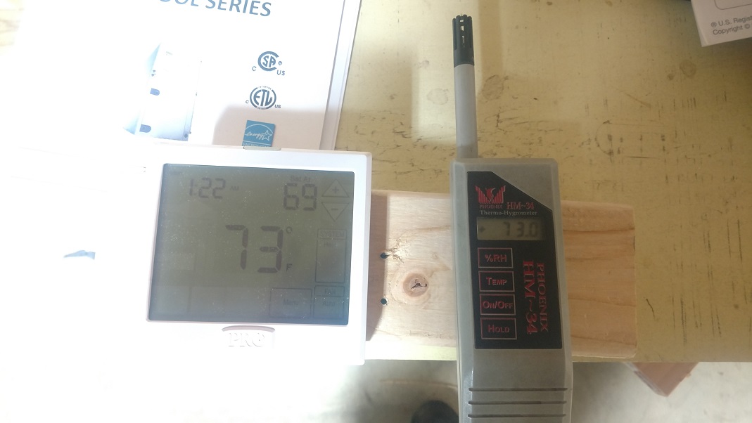

Here is an example of the t-stat lag.
Pic 1 is right when the unit shut off. The t-stat wasnt reading the actual temp....too much lag.
Pic 2 is ~30 minutes later when the t-stat finally caught up to reality.
Just got off the phone with tech support too. He agree that the t-stat shouldnt have that much lag.
Also agreed that there shouldnt be any voltage on Y1. But this unit as an A1 terminal as well on the board, that is for accessories. So I switched the bard (hot water circulator pump) over to that terminal. As its not tied to the t-stat and thus, doesnt have any lingering voltage causing it to want to run when the furnace itself isnt running. The 18v on Y1 still aint right, but at least I am not wasting energy circulating my hot water through the DSH now.
They are sending me a new t-stat with the temp lag being what it is, and the 18v on Y1 even with the unit off, something just aint right.
