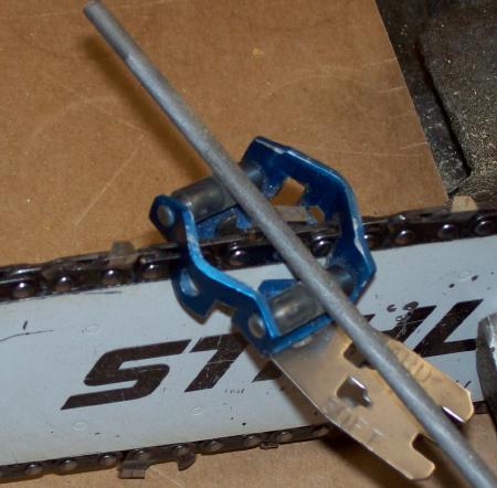

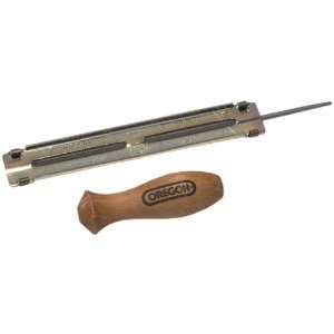

There's a lot of ways to sharpen chains, so you can pick what works for you. I hand file 90-95% of the time. I had a lot of practice doing that when I worked for the USFS. The trick is to make sure you're filing the underside of the tooth. That's what the simpler guides like the Oregon guide that fits around the file do for you. The more complicated guides like the Granberg File N Joint do that and also set the angles. I've tried those and the Stihl equivalent and don't like them. I don't see much use for a tool that automatically sets the depth gauges. I file them with a gauge every 5 filings and they don't need much filing. I could go longer. I sharpen my chains every 2 tanks max. More often if it needs it. A sharp chain is a happy chain.

I've tried the Stihl 2 in 1 (which is actually a rebadged Pferd Chainsharp CS-X). My friend has one and loves it. I found it fast and easy to use, but my chains cut better with either the Swedish Roller Guide Husqvarna sells, or the plate that clips to the file that Oregon sells
