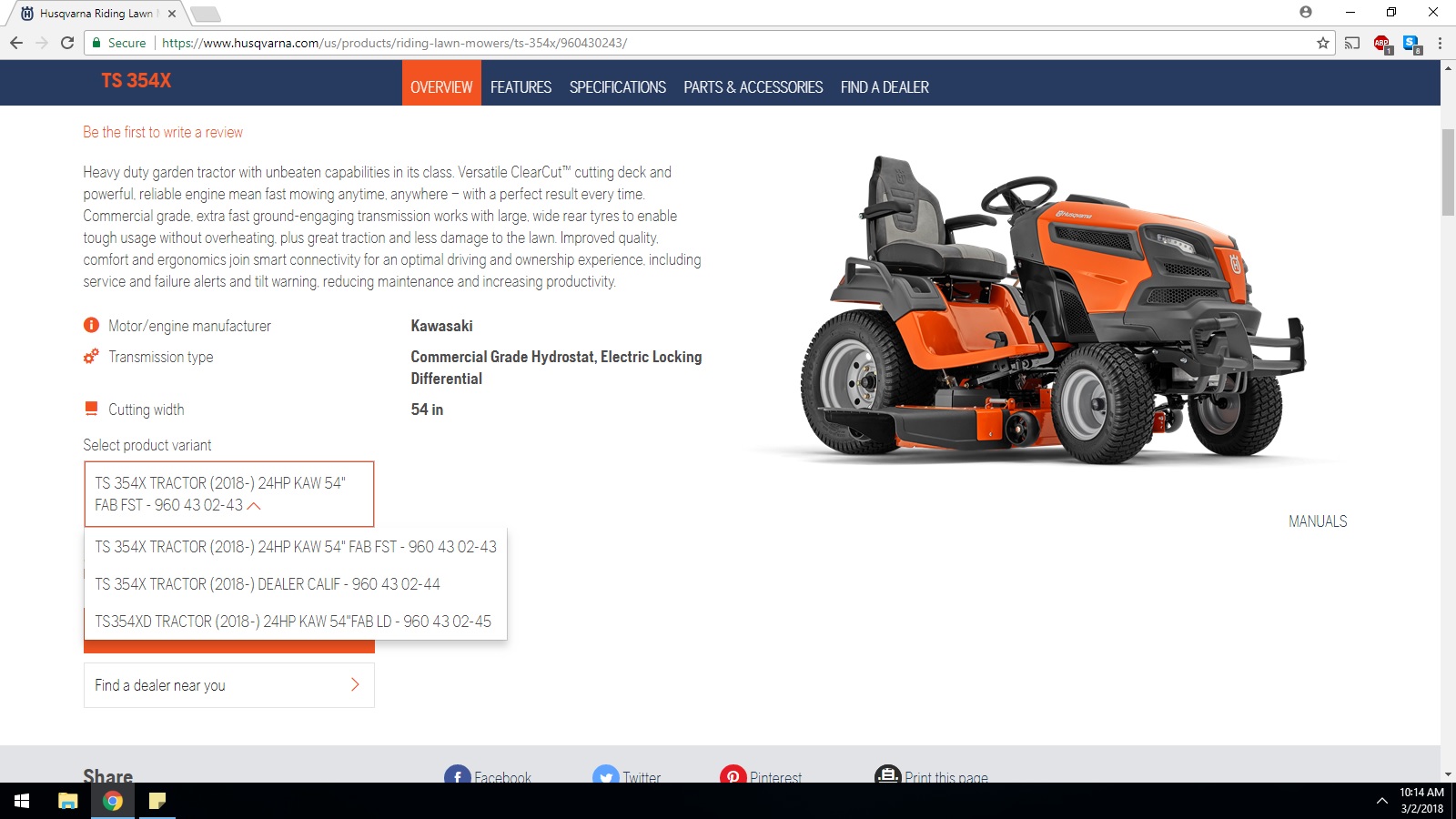

I honestly think that Husqvarna is in a hurry to get their site updated before the start of the season as information keeps changing and moving around. One minute I can search for a model and it comes right up and the next minute I cannot find it without digging around.
So according to the site, there is a TS354X and a TS354XD, the only difference being the transaxle. So you have to choose between a locking diff (Tuff-Torq K66ELD), or the fast hydrostatic (Hydro-Gear G730) with the locker costing $100 more. In looking through the manuals and the illustrated parts lists, that appears to be the ONLY difference in them. I have spoken with my local dealer and these models will not be available until mid April. It is a darn shame that John Deere could not offer the K66ELD in their X380 for the same price they already sell it for. That would make the decision to go to the John Deere a bit easier. With their sale that just ended, the difference between the the X380 and the TS 348XD was only $500 with the Deere offering a better engine, better warranty and overall better build quality. But now at a $1,000 difference, it make the Husqvarna look more attractive. The only gripe I have now is that Husqvarna still continues to use steel bushings on the front wheels instead of ball bearings. Yes, it is easy to maintain and even replace when they wear, but the bearings in the X300 or even Cub Cadet XT2 series is a good move for reliability.
