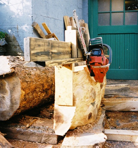

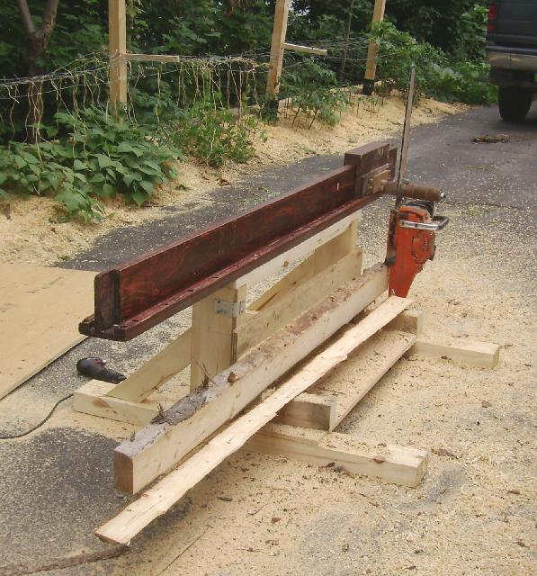

More engine revolutions for the same work means reduced engine life for the head fitted with the oversized bar.
With this statement in mind should one only purchase the largest head available.:confused::confused:
Please remember the suggestions for a longer bar are not for mainline use. Only for those times when a little extra length can be utilized. The Long bar does not always have to stay attached to the saw. Maybe it can be used only when required.:D
For the two saw's I have, Husky 55 and Husky365 I have bars that range from 13 inches to 24 inches in length. There are also some different types of chain. Different bars/chains get used for different purposes.:D
