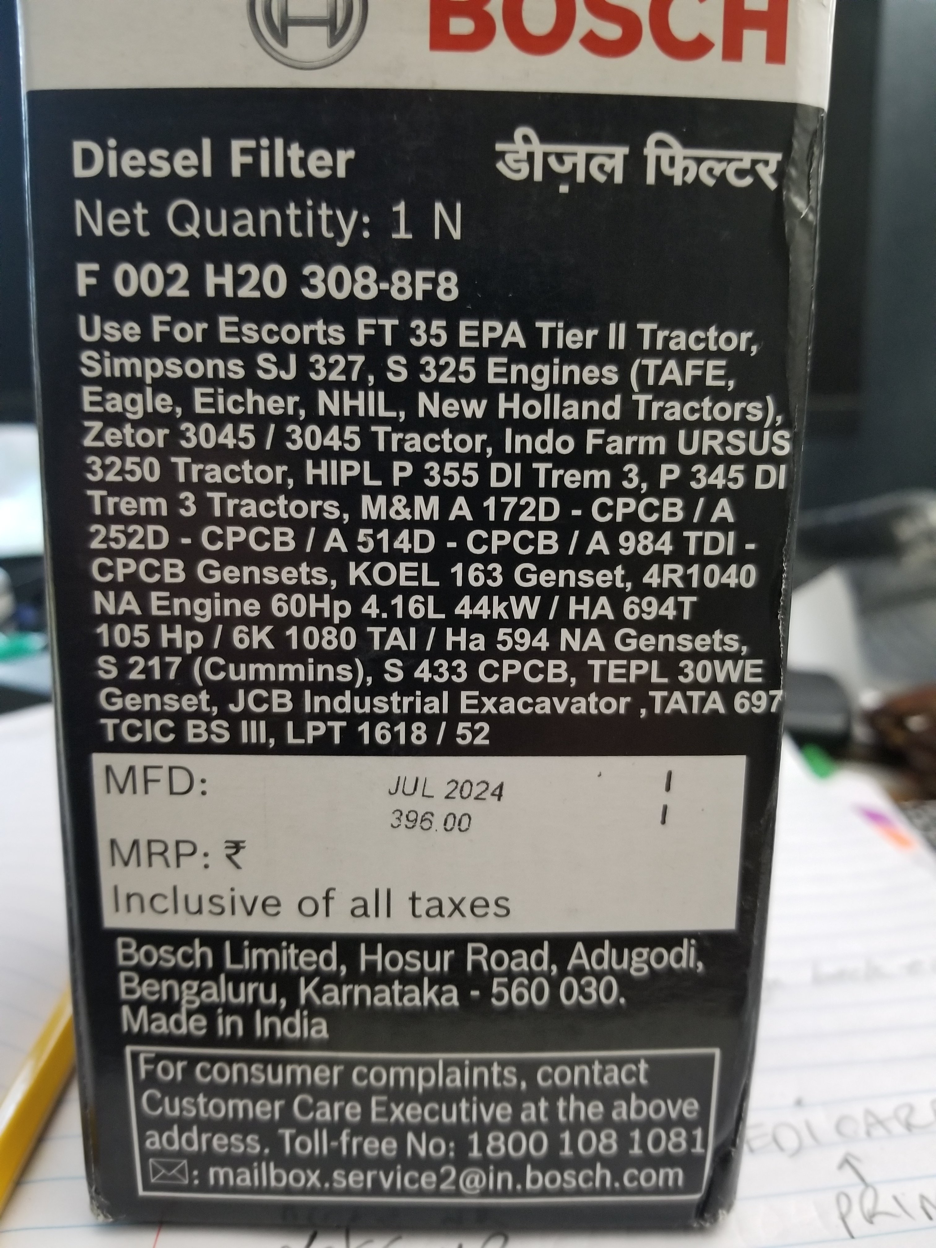

OIL: Wix 51515 FRAM PH8A
Water Sep: Wix 33472 FRAM P8043 I also found a BOSCH PRE FILTER F 002 H20 308-8F8 made in India
Secondary Fuel: Wix 33358 FRAM 4102A
Hydraulic: Wix 51712 FRAM P3952
Air Filter: Wix 42533 & 46534 FRAM CA 4304 & CA 4262SY FleetGard AF1855 & AF1766
The above correlate to the FARMTRAC 545DTC
