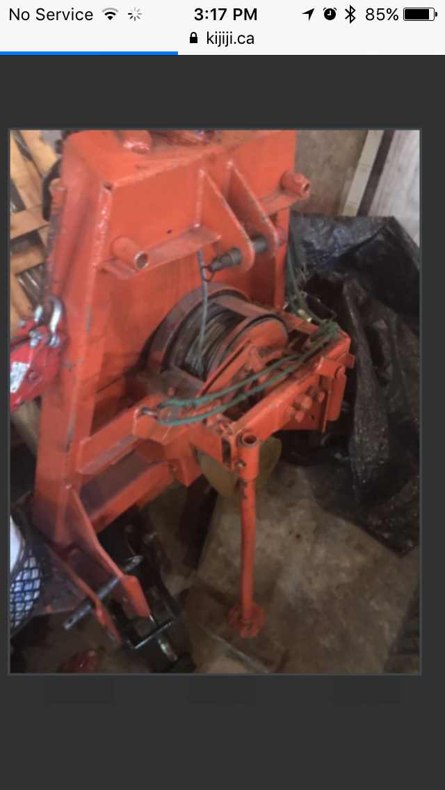

Yes, I saw the sale. Their good guys at Hudson. I found a second hand farmi for sale about 2200, plus a 550$ Canadian dollars roundtrip for me to go pick it up. He said it was 5 years old, women who's husband passed away was selling it. However, I'm still tempted on the uniforest as I know those guys, good guys. Hudon was possibly coming up this way so he could bring it up in a year or so...and if not, he could delivery for 400 American, with about 2995$ amercan price tag. However I could exchange it for some services I provide, that normally costs him, and thus reduce the price tag further.
So its hard for me to say either way. I did tell the used farmi guy I'd drive over, which is a 8 hour ferry ride, and 6 hour drive to get the winch, no deposit, on the used one. But I'm starting to go on the fence and would like to tell him I Might be going with the uniforest....I don't know. Uniforest Unit is new, farmi is used. What do you guys think? farmi, 2200, plus about 550 for me to pick it up. Canadian.
2995+400 American for uniforest, but can essentially get a lot off of that if I can provide a service for him next year and he can bring it up.
