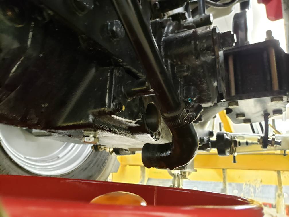

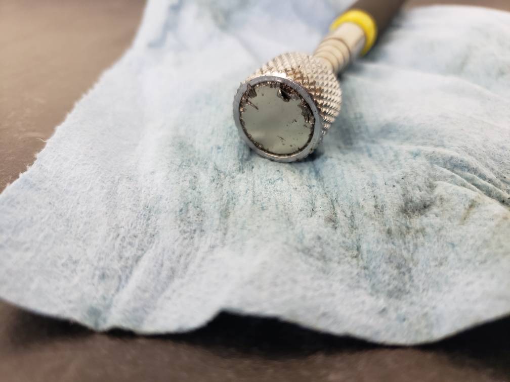

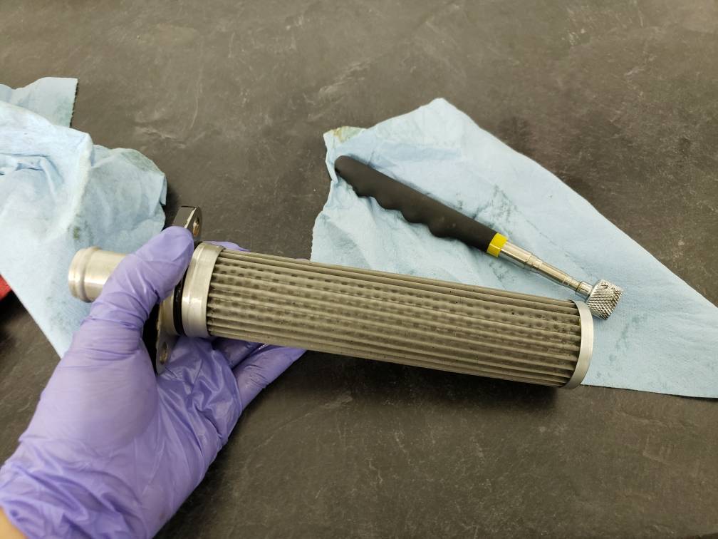

/ HST273 OIL FILTER? #11
Don't forget to pull your strainer and clean it. I also put a magnet in the hole to check for metal pieces.
Thanks Tiptoo, I just ordered 2 of them. Appreciate it much. Greg
