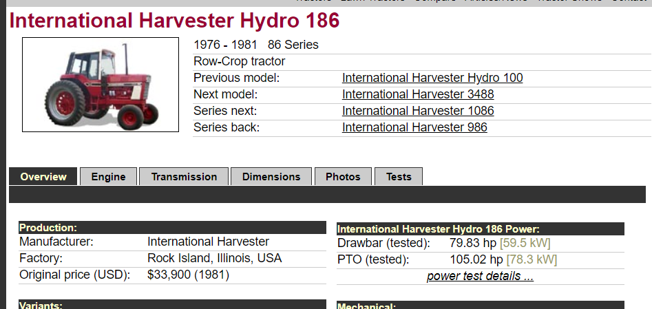

It would be interesting to see an accurate comparison of efficiency with a 50hp HST versus a 50hp gear drive doing the same ground engagement task. I would suspect the fuel useage after a few hours would be much different. Maybe 25% or more?
I don't recall ever seeing such a comparison.
Below is a comparison of 2 similar older higher HP tractors with gear drive vs hydrostatic. Max drawbar pull in #s 986=5938#s @5.69 mph 186=5032#s @5.95 mph
