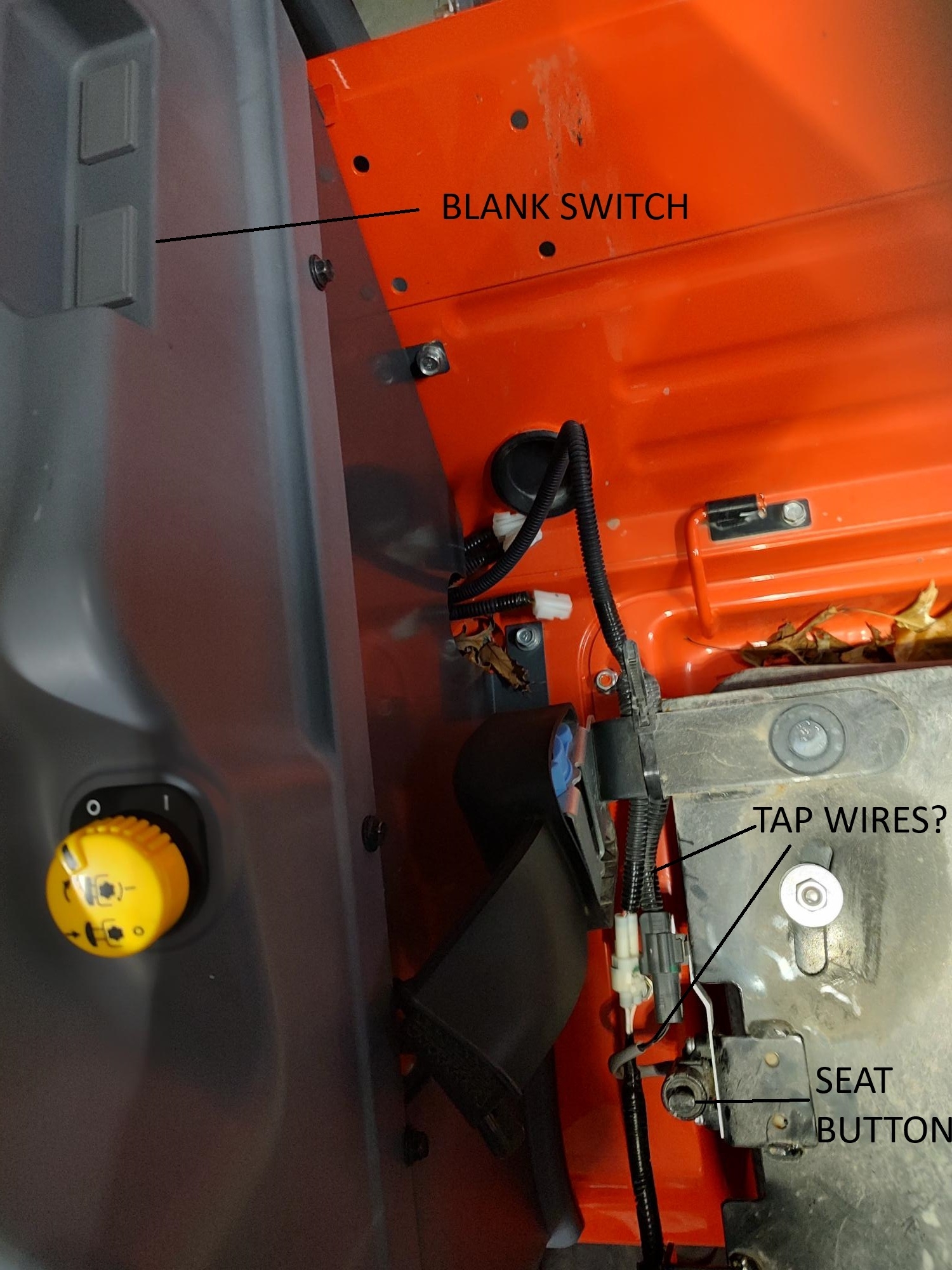

I have an XR4046H, an HST model with the backhoe attachment. With the parking brake set, I use to be able to set the parking brake, get off the driver seat and transfer to the backhoe seat to operate the backhoe. If I do now, the engine dies. When I engage the parking brake, the icon on the console display lights up but does beep. The PTO is disengaged. When I get off the seat, the engine dies. I know the seat sensor is working because it runs until I get off the seat. I know the parking brake sensor is ok because the console icon lights up when engaged. I know the PTO switch is working because the console Icon lights up when engaged. Is there another safety interlock I'm not aware of?

I would suspect the "Neutral" sensor for the pedals.
If the seat safety switch isn't closed (Someone seated) and the neutral sensor is activated (Not sensing the pedals are in the neutral position) it will kill the engine for safety.

Can you tell/show me how you wired the toggle switch? Here's a photo of my 2023 Kubota L4060 wiring. There appears to be two safety switches, one is a plunger/push button and the other is inside the seat bottom.
The pictured switch is for unattended pto operation. I don't think defeating it will let you inch the tractor out of the seat. The in-seat switch will.
Not certain, but I believe adding a wire with a switch from before the safety switch to after the safety switch will complete the circuit when your added switch is on, and return to normal operation when your added switch is off.
