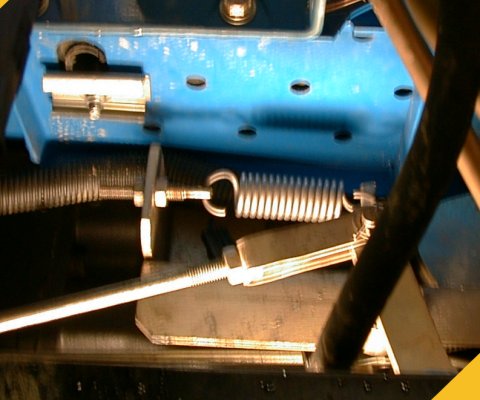

Here is a picture of the stock TC-40D return spring and mount assembly. Notice that my adjustment is just about maxed out on the tension adjustment.

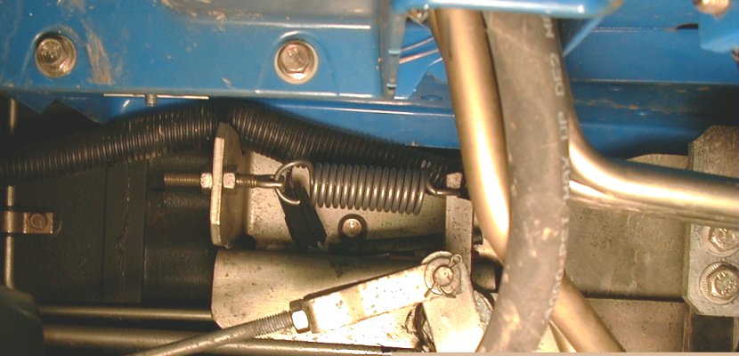

Here is a picture of the modified TC-40D return spring and mount assembly. Notice that there is still plenty of adjustment that may be made to the return spring. The spring itself is also much larger.

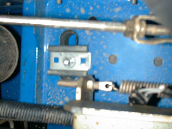

Here is picture number 2 of the modified TC-40D return spring and mount assembly.
Although the return spring is larger the HST pedal is easier to push and feels a lot smoother in operation.

Thanks, Mike and Spencer200! Great photos and great info. Last Sunday I stalled my tractor for the first time in a long time. I had it in low/rabbit and started up a hill with the engine rpm too low. When I instintively went to lift my foot to do a gear change, the pedal just kept travelling down by itself until the motor stalled. /forums/images/graemlins/blush.gif /forums/images/graemlins/frown.gif If I had had the rpm up or was in a lower range it would not have happened.
By the way, the tractor was stopped while all this was going on. The hydro was completely in stall mode. As soon as the engine quit, the pedal popped back into my foot, so I can definitively say that the tranny was responsible for the problem and not just the pedal mechanism. I think I'll ask my dealer about ordering a kit for me. /forums/images/graemlins/cool.gif My warranty is long-gone, but this is something I want to take care of.

I just came back in from using the snow blower for a cup of coffee and to warm up. We are getting hit here in Ohio with one of the biggest snow storms of the season. Between my neighbors drive and mine I have been at it for several hours. I haven't yet been able to make the HST pedal stick since the kit was added and I have purposely let the RPM drop to around 1500 a couple of times to see if I could get any kind of negative response on the low end.
I'm hoping the HST pedal acts this smooth when I am pushing into a pile of dirt with the FEL instead of the snow I'm moving with it today.
