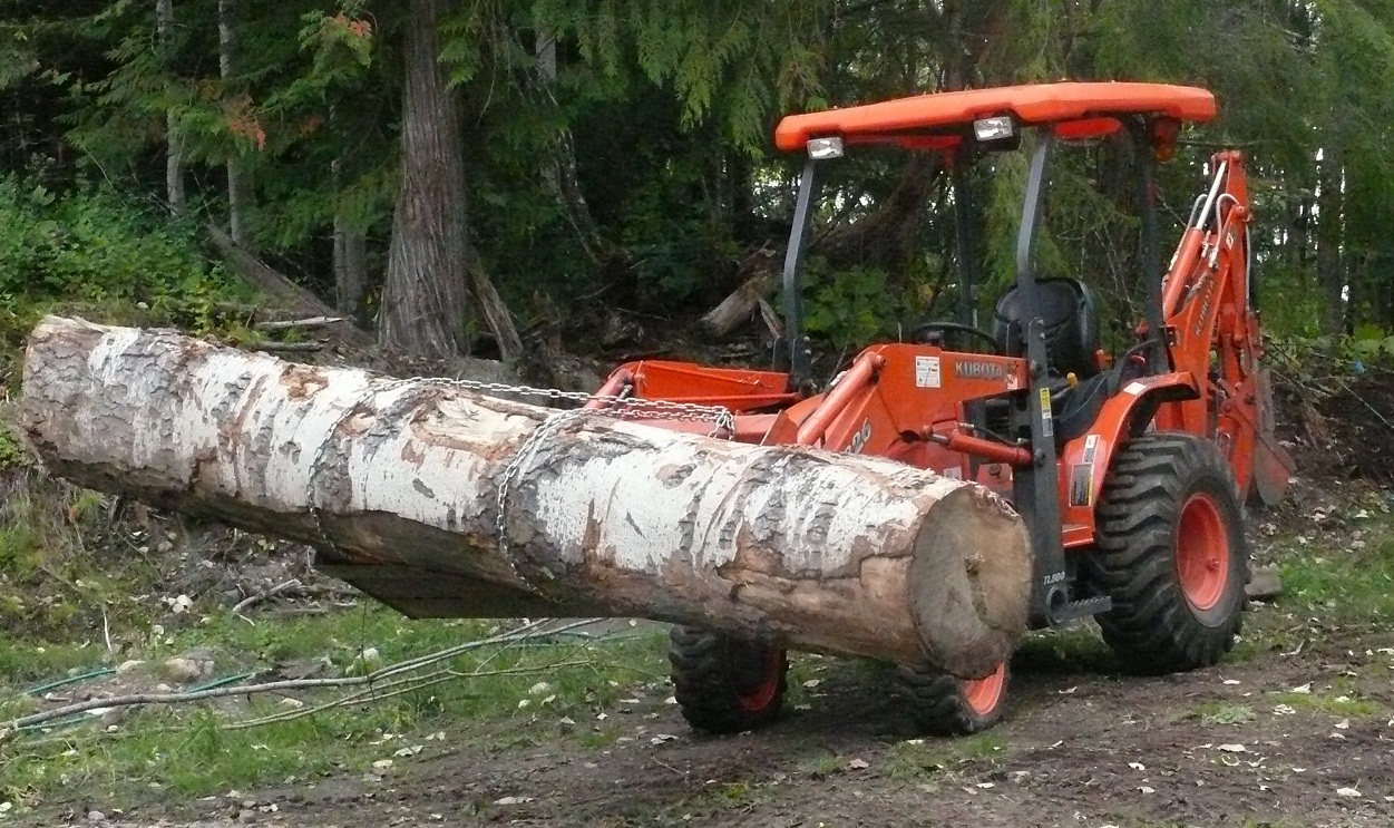

Aside from this issue I am extremely pleased with this tractor. I am continually amazed by what it can do.:thumbsup:
