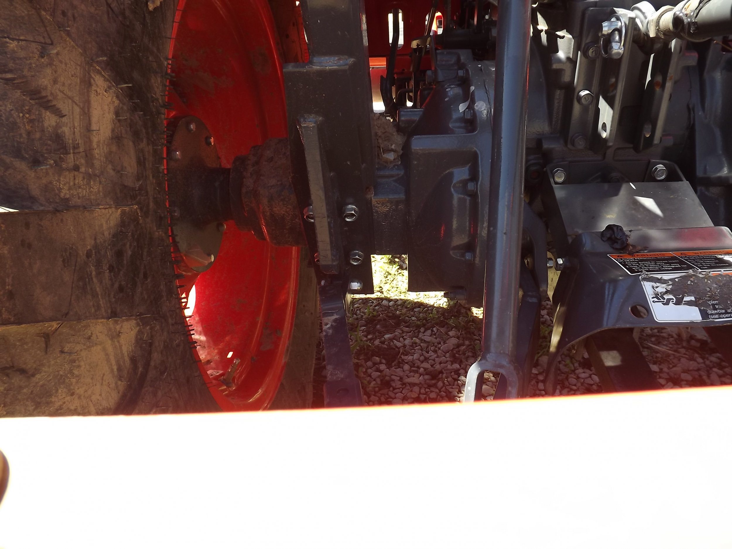

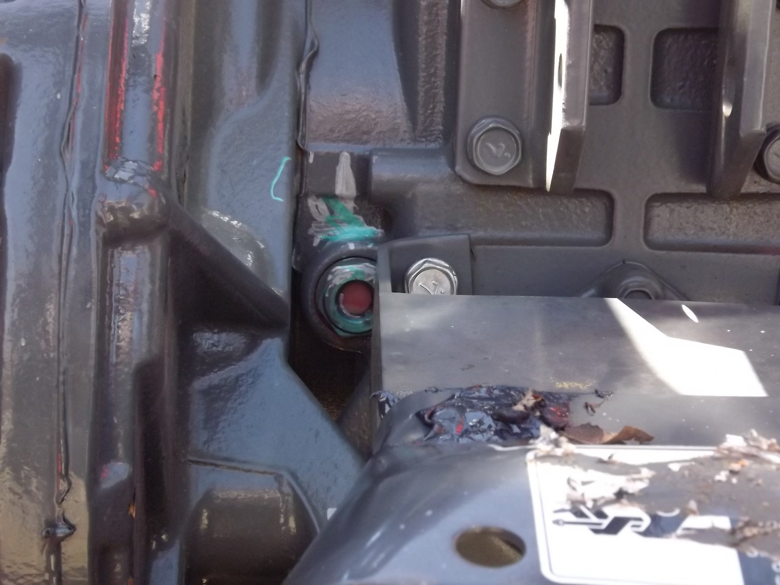

Installed JD red dye and tried to get pics yesterday. Sun was in front of tractor and not sure I got pics. Posting and looking myself......I can't find it in theone pic but can in one due to red spot and light blue magic marker around it in the other pic.

Installed JD red dye and tried to get pics yesterday. Sun was in front of tractor and not sure I got pics. Posting and looking myself......I can't find it in theone pic but can in one due to red spot and light blue magic marker around it in the other pic.View attachment 692530
Just curious as to what all the 'goobering' at the edge of the PTO shield is all about? Looks terrible, not OEM. Looks like someone blew their nose there....lol

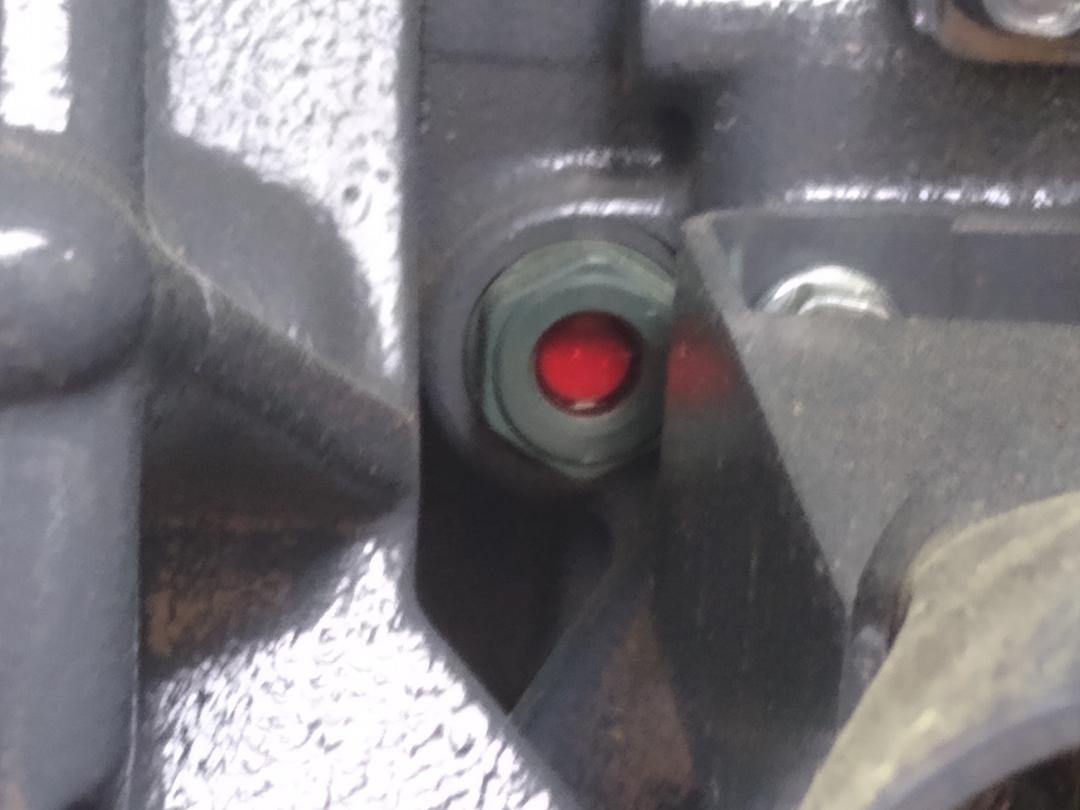

I bought the JD hydraulic dye through Walmart.com. Got it within a week and added the entire contents (< 2 oz) as the instructions stated.
Definitely made a difference in visually seeing the hydraulic level through the sight glas.
