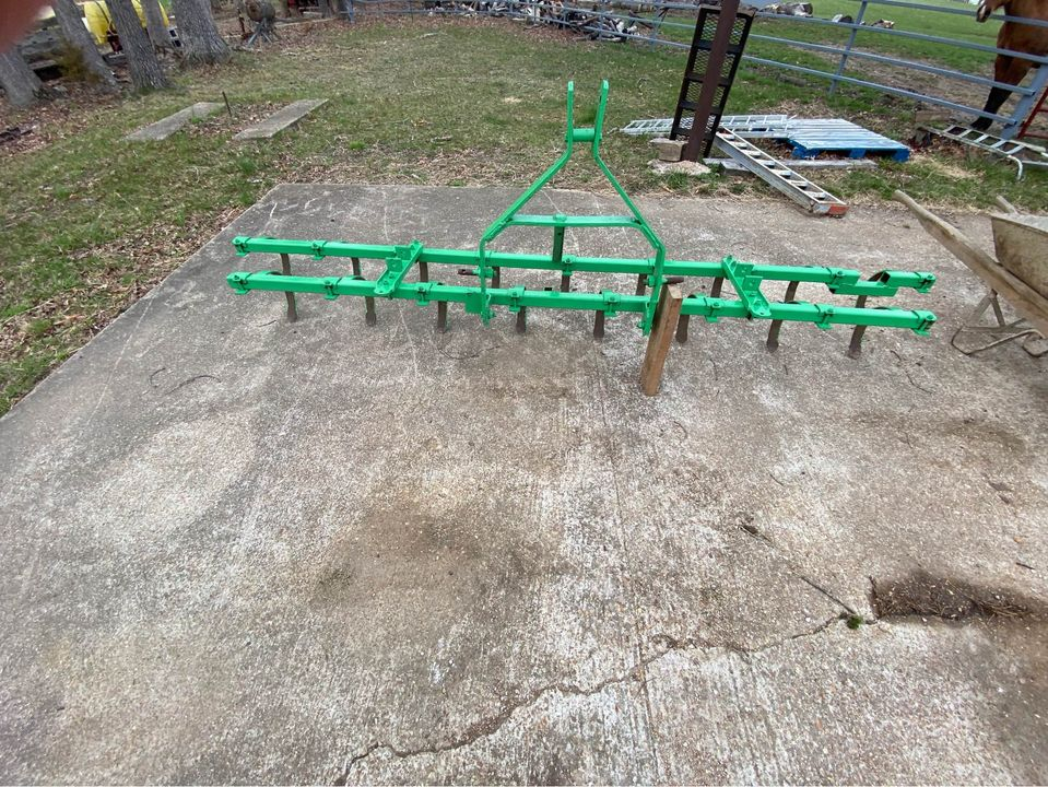

How much tractor weight and HP is needed to pull something like this 10.5' Cat 1 field cultivator?
View attachment 740451?
Depends on field conditions. For what you mention, going back through previously tilled ground to rip up weeds, a 50ish HP utility tractor like your 2150 would probably be fine, although if the soil is particularly heavy or dry and caked, you may need something with about another 20 HP and another ton of weight. We pulled a Deere field cultivator about that width with sweeps and a tine harrow with an 80 HP tractor and it never had any issues with it. That cultivator did also weigh a good ton or so, it was a lot heavier than the one you have. If you do find this is too much to pull with your 2150, remove shanks until it pulls it well.
