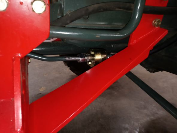

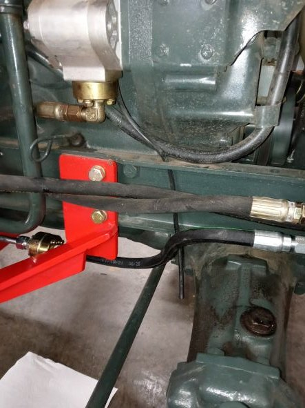

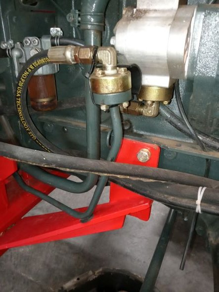

I'm plan on removing the 12mm HP line from the banjo bolt to the pump to improve the routing due to issues with the FEL structure and since the FSM does not include specific instructions like many automotive manuals do are there any do's or don'ts associated with the removal. I assume the line will weep fluid until empty but what about the banjo and pumps ends, anything to be concerned with.

Two copper gaskets, they can be annealed if needed, probably not needed.

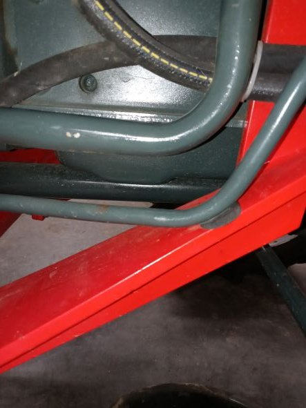

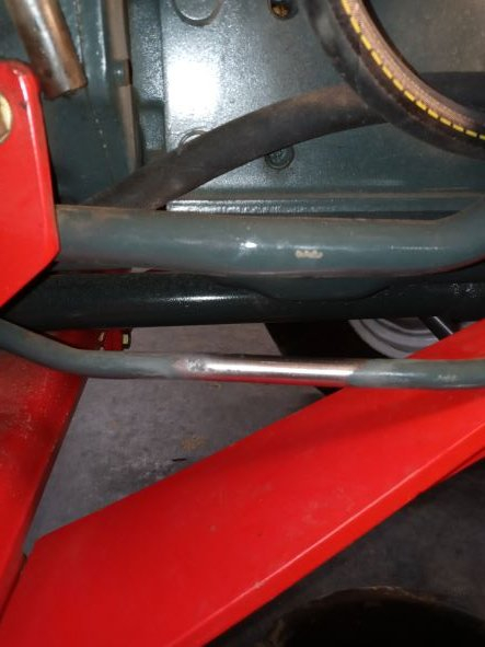

Finished cleaning up the hydraulic rats nest and it went well, no leaks and everything works fine. The way the builder tapped the HP outlet it required a slight bend in the hood panel and the flange was riding the edge of the pump along with the line hard up against the FEL frame, something was eventually going to let loose. Can also finally check the oil without a roadblock.
