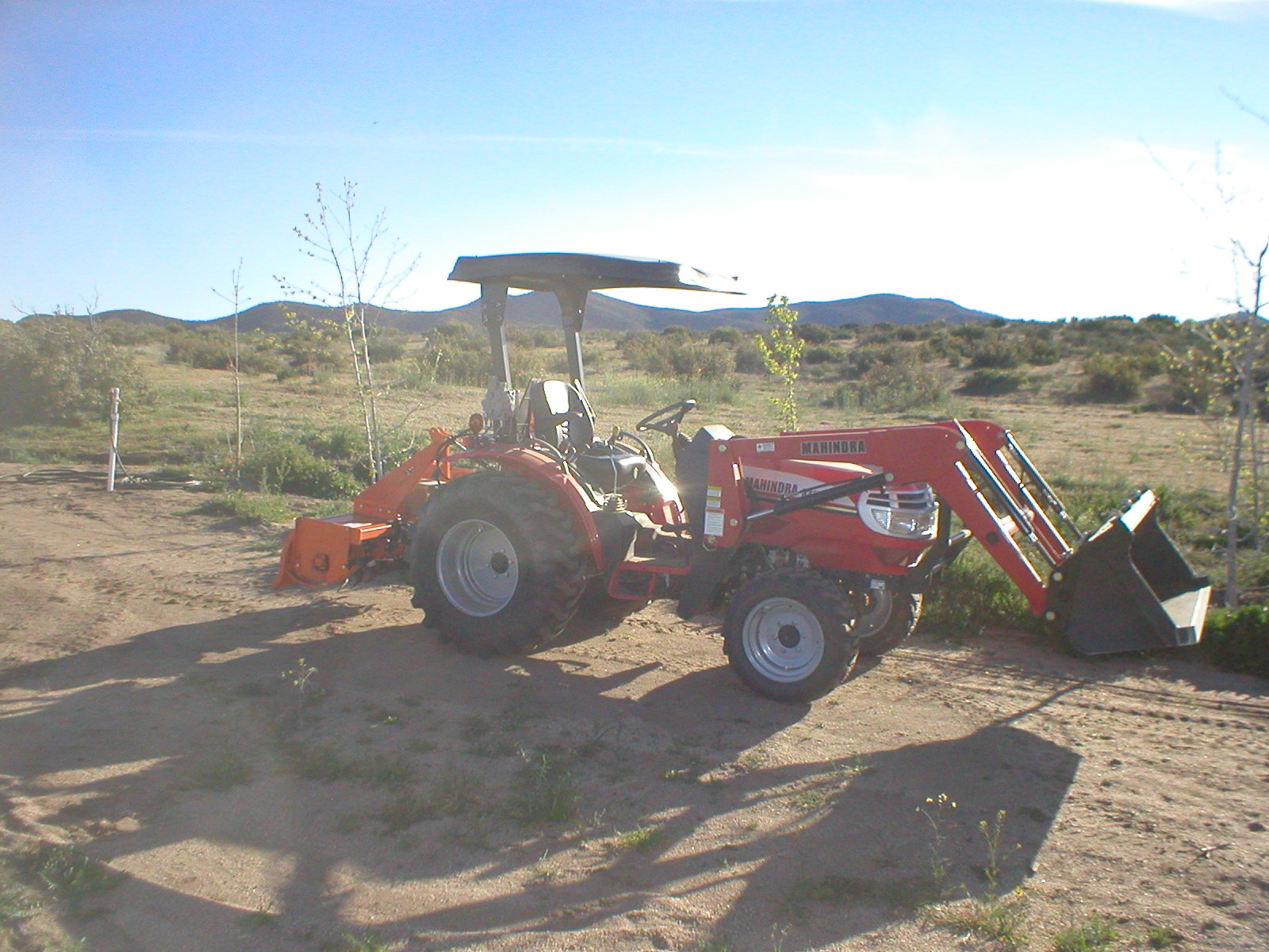

   / HP how much do I need? #6
I use a 58" tiller with my 3215HST with no problems. Most likely could use of a 72" tiller with out any problems. So yes you would be fine with a 60" tiller behind a 3215.
