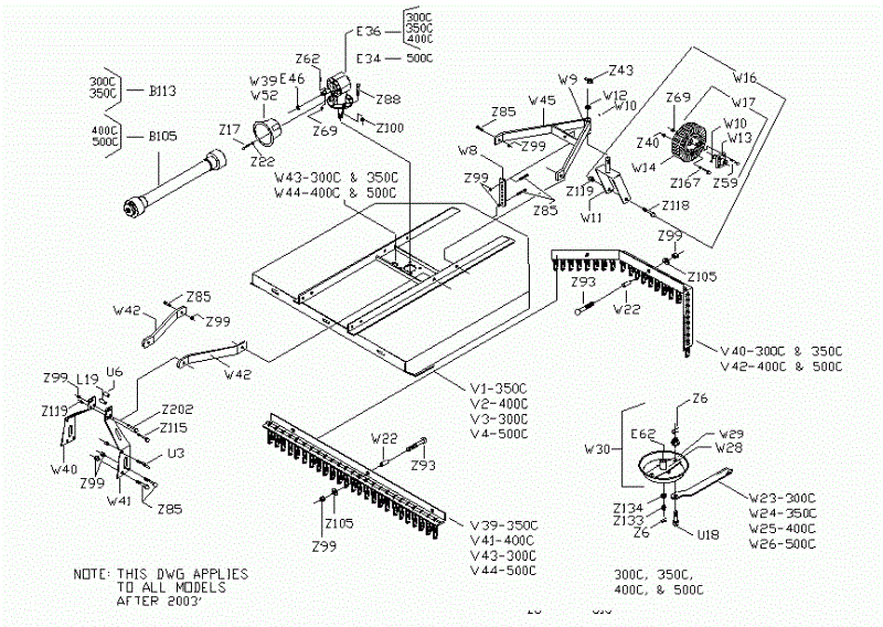

I just got a Howse Bush Hog. How do I disconnect the PTO? It does not have spring loaded pin like my old King Kutter.

There are a few different styles out there. Some have a collar that you have to pull back before it will slide off the PTO, some you have to twist and then pull it off.

If it has a plastic collar slide it back toward the mower. This will let the balls release from the groove.

I have a Howse also and on mine it has a yellow plastic collar at both ends, while standing over the PTO shaft, i turn it left and pull. here is a pic of a parts diagram for the rest of the cutter in case it is of any help with other things.

Mine rotates counter-clockwise to release the pto shaft. It's bad about rusting if you leave it out in the weather so I have to keep it well greased. Howse likely used many different types on their rotary mowers, they just put on whatever the Chinese shipped them that week.
