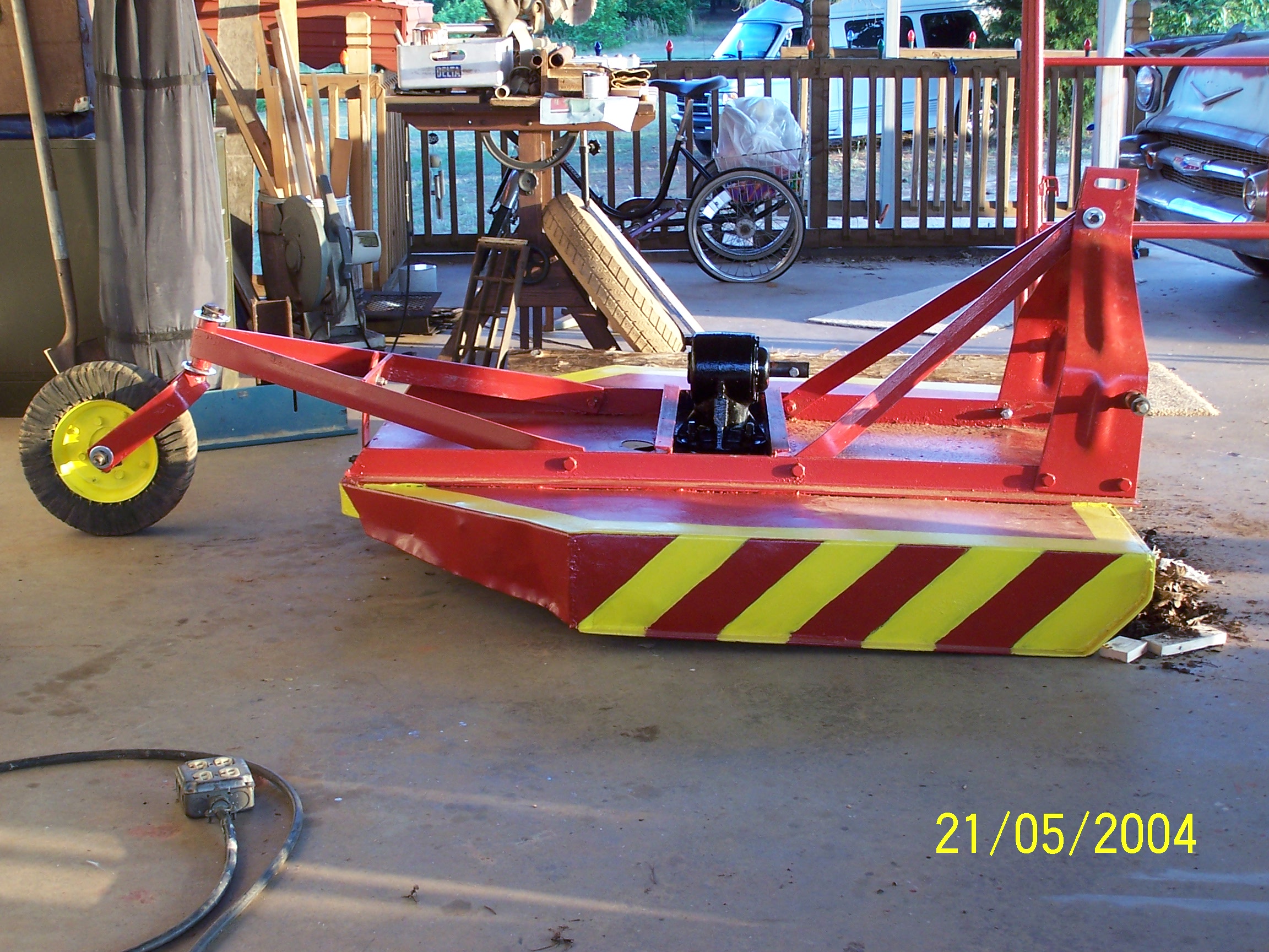

I have a 5 ft. House its really old, I traded a model airplane for it several years ago. After cleaning an changing the oil. I use it every year its a good mower.

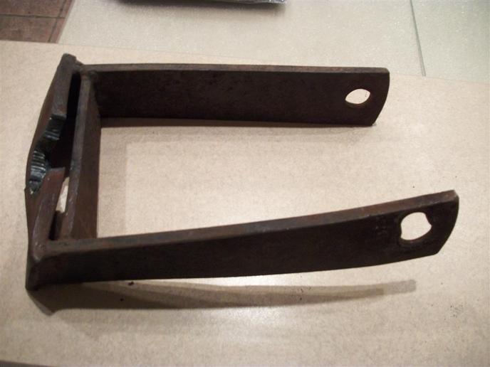

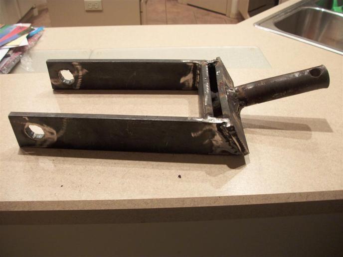

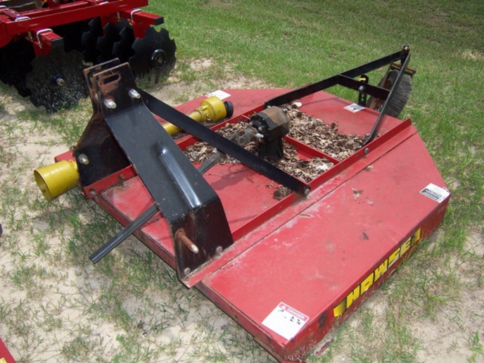

i just got a howse 5' mower for next to nothing from a local dealer I buy a used tractor or implement from yearly.. he usually sets aside stuff that comes in on trades that needs fixing and can't/won't sell and I get it for scrap prices as he has no real facilities to fix much there.
i had to fab a new tail wheel fork and buzz up pne cracked weld, tighten some nuts and bolts and tighten a 3pt lift pin.
gear box had oil in it but some moisture so flushed it with diesel and refilled.
twist coupler was frozen up.. i set it into a bucket of used motor oil thinned with diesel while I worked on the mower. got it freed up.
mower is now ready for light duty fence trimming and row mowing. my cost? some electricity, welding rods and scrap 3/8x2" bar stock, a couple bolts and some time.

Hey Soundguy , just wandering, do you have a pic of it after you put it back together? Looks like nice cutter and an easy fixer upper. :thumbsup:

Soundguy, that thing looks in great shape for the price. If you even paid the scrap price for it you may have paid what $40 at most? That thing was backed into a hill with a good sized tractor or something. But dang not much wrong with it. Looks used for what a few years at most! Bet it hasent mowed 60 acres and prolly has less than 50 hours on it, unless they kept it inside untill the end of life.
i'll get a pic of it today witht he new fork installed.
yep.. it was cheap and i think I got a great deal on it.

/ Howse Brush Hog #19
Soundguy,
That is the exact brush hog i have. Except your looks new compared to mine. I have totally abused mine and it is still mowing strong. The shape that baby is in you should get many good years out of it for sure..
BTW- my tail wheel did the exact same thing.
/ Howse Brush Hog #20
it's fixed and running fine now. I sharpened the blade.. checked the gearbox lube again and off it went.
