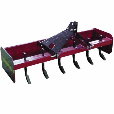

I have just ordered a 5' Cat 1 Howse Box Blade from Northern Tool. I know I am doing this backwards (should have posted first, then ordered /forums/images/graemlins/tongue.gif) but does anyone have any comments on them?

Just judging my the picture and description in my Northern Tool catalogue, I do believe that's the same box blade I had for my B2710; worked just fine.

It weighs 447 lbs. I had to pay to play /forums/images/graemlins/laugh.gif Total was $432.23. Truck frieght was the killer ... $132.24. /forums/images/graemlins/smirk.gif This was still better than I could get around here though.
I'll try to write a review after I use it.

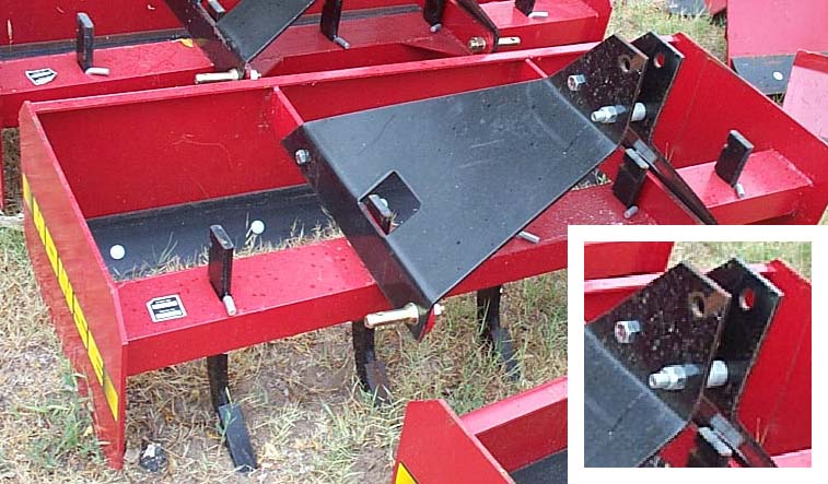

The truck just left after delivering my box blade /forums/images/graemlins/smile.gif. At first glance I am pretty impressed with the construction, heavy duty. Not so impressed with Northern Tool. It was sitting in the back of the box truck on a pallet, not secured to it /forums/images/graemlins/crazy.gif. There were fasteners lying loose on top of the pallet; one nut, bolt & lock washer together and a loose nut and bolt just laying there with no lockwasher. I don't even know if there is supposed to be only two bolts, others could have been lost /forums/images/graemlins/confused.gif.
They will be getting a letter of complaint.
Probably won't be able to play with it, I mean work with it until next week sometime, if everything is there at least.

Could the nuts and bolts you found have been what had secured the blade to the pallet before they removed it?

Norm,
Unfortunately not, the 1/2" x 2 3/4" bolts are used to fasten the 3ph mounting plates together (see pic). After visiting the Howse Implement website, I also found that two spacers are missing that keep the plates spread for mounting the top link. I'll just buy some grade 8 bolts and a piece of galv pipe for the spacers until the replacements come. /forums/images/graemlins/confused.gif

If you send a letter of complaint to Northern Tool, (I think they assemble the units prior to sale), I would also copy Howse on the problem. That lack of quality workmanship is inexcusable and makes Howse look bad.
/ Howse Box Blade #16
The picture looks just like the Howse box blade I picked up new at an auction last week. The bolts were attached to the box, threaded together and the plate arms were wired to the box at the top, all parts were attached lucky for me. My high bidl on the 48 inch hinged back was $220 and no tax. I was pleased.
