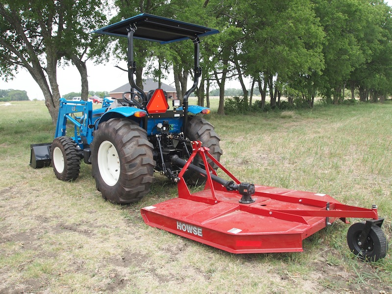

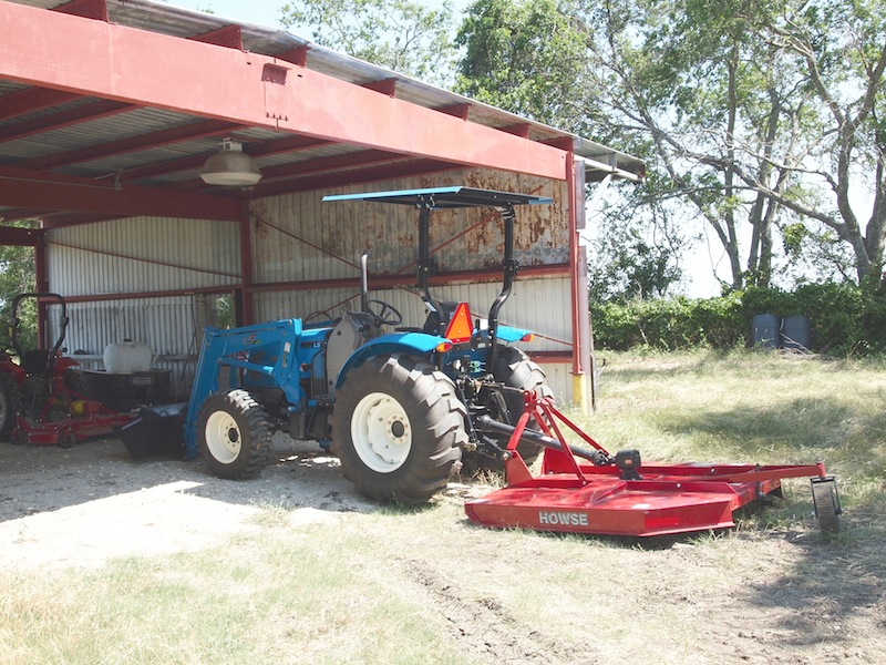

I ran a 48" Howse mower/shredder from 2004 through 2010 to cut 6 acres here in Texas. It's a bit of a crude machine, but it ran without a hiccup on the back of my 24 HP Yanmar CUT. Cast iron bearing on the tail wheel that needs grease regularly. I never touched the gear box. Howse gets a lot of knocks, but my experience was good.
$800 sounds a bit high to me. I'd offer $600 and see how the seller reacts. I'll bet he takes it.
Here is a picture of it from May this year, just before I sold the whole rig:
