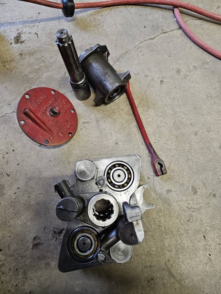

Not that I wanted, but I'm forced to sell some prized possessions. Because I need to dig a new well at the cost of about 10k
Selling a Howard gear reduction unit that came out of an 8n. I know it's a premeum price, but I need the cash. I've listed it on ebay here is the link.

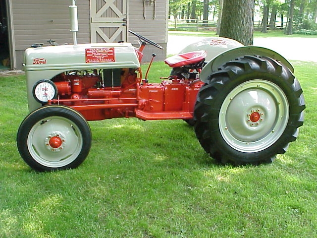

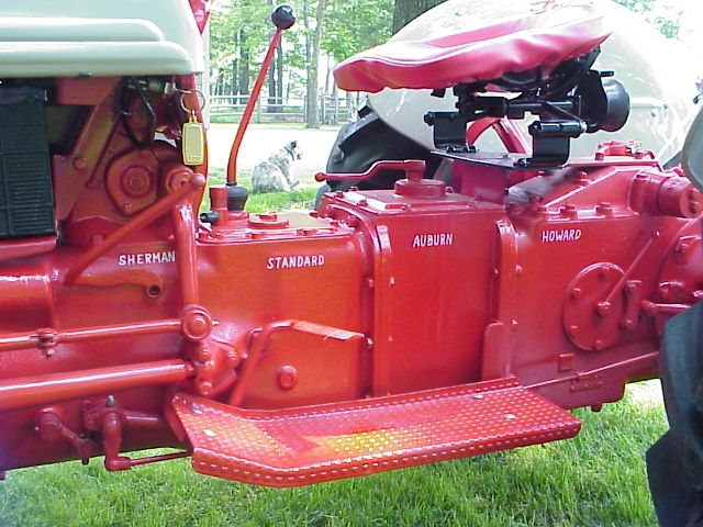

/ Howard Gear Reduction #3
They were aimed at Ford tractors in order to use Howard's roto-tiller, which they called a "rotovator". It's not an auxiliary transmission like the Sherman and the Hupp, it's more of an auxiliary rear end to slow the tractor while allowing the PTO to continue to spin at 540rpm. You can't do that with an auxiliary tranny like the Sherman. The photo shows the extra shifter below the lift lever which is a giveaway that a Howard may be inside.

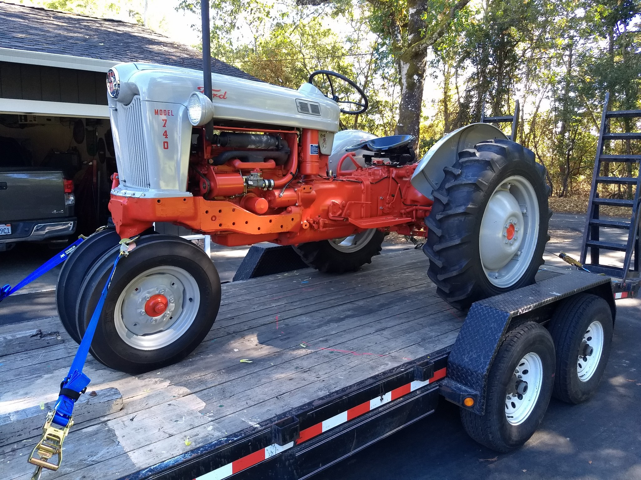

/ Howard Gear Reduction #9
The Howard is on my 740 Row Crop
