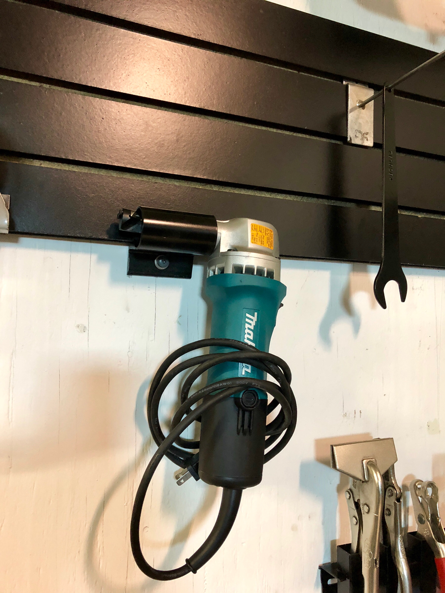

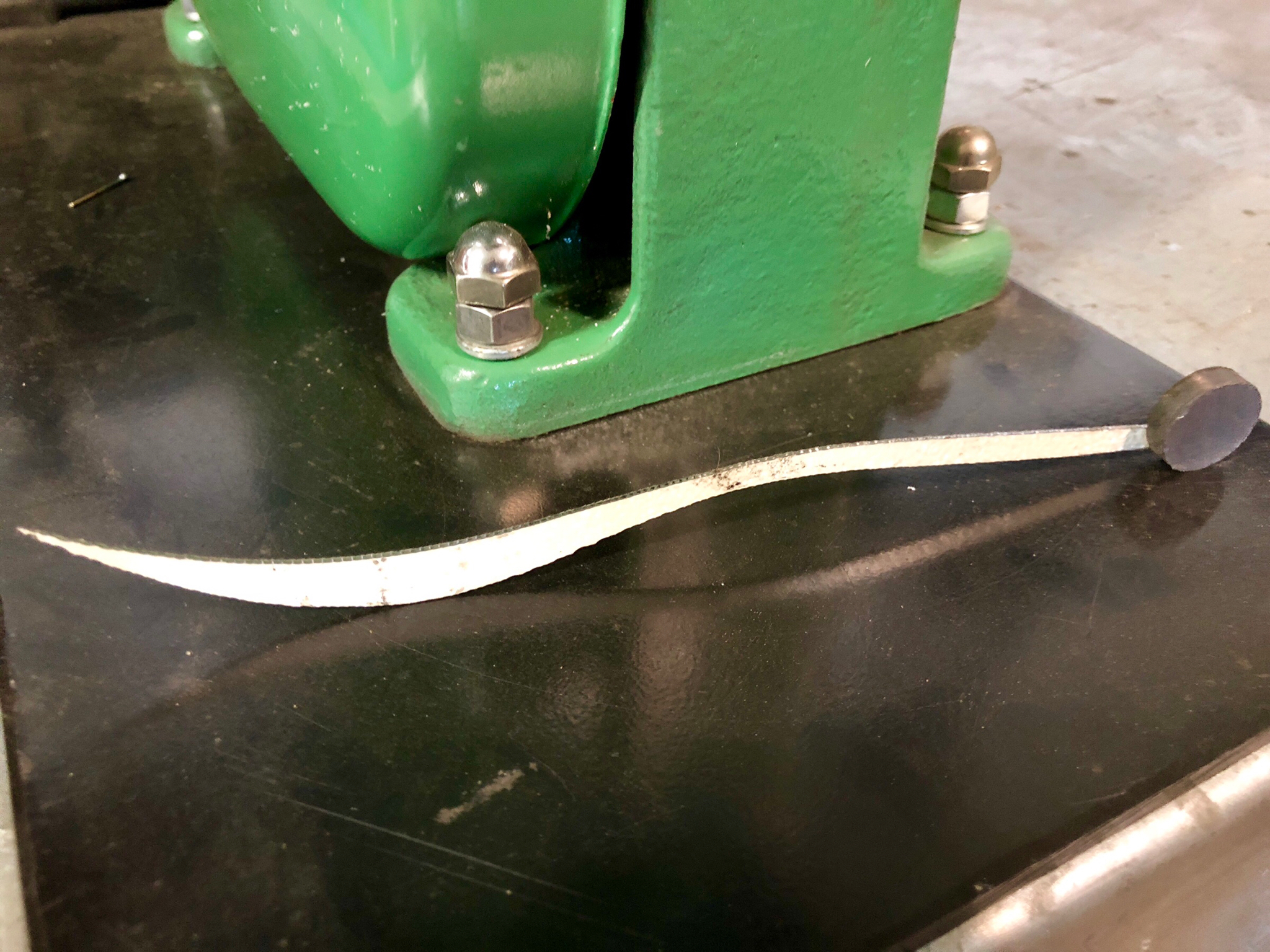

Nibblers are awesome. Mine will do 16 gauge. The 10 gauge model was too physically big for most jobs and WAY too expensive.

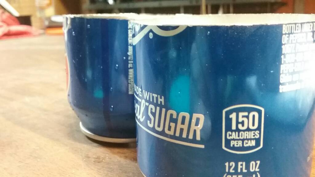

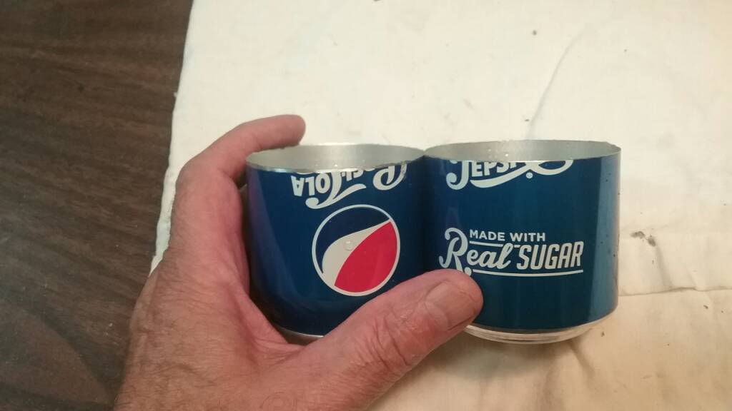

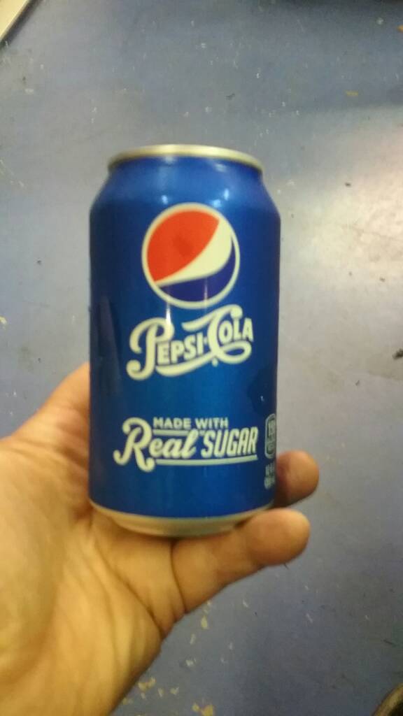

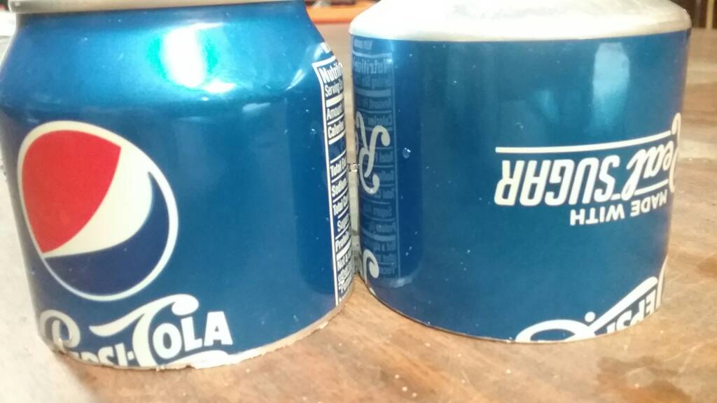

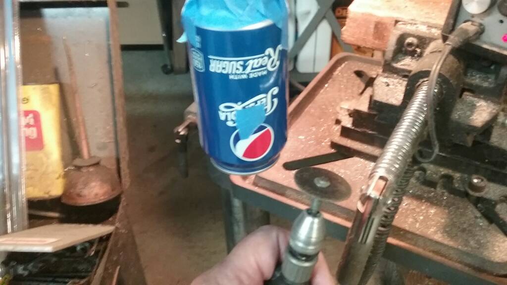

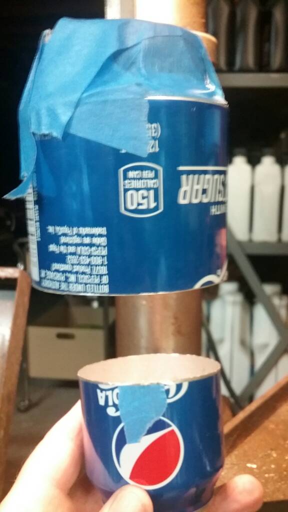

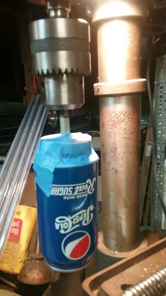

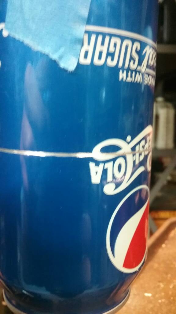

I knew if I could cut my favorite Pepsi exactly into I could do it with any can, even coffee. It only took a few minutes.
1) set drill press on lowest 250rpm speed
2) marked can 1/2 way point, piece of masking tape there. As it spun, easy to see
3) small Dremel tool, low speed with cut off wheel
4)used a small stone, taped it to can, chucked in drill
5) as drill slowly spun can, lightly held other end so it spun evenly...
6) Dremel wheel touched to mark as it ran
7) you could hear it change pitch as it easily cut thru...voila!
Both halves same size, no rough places.20181010_174910.jpeg20181010_174110.jpeg20181010_174235.jpeg20181010_174329.jpeg20181010_174424.jpeg20181010_174631.jpeg20181010_174706.jpeg20181010_174734.jpeg
