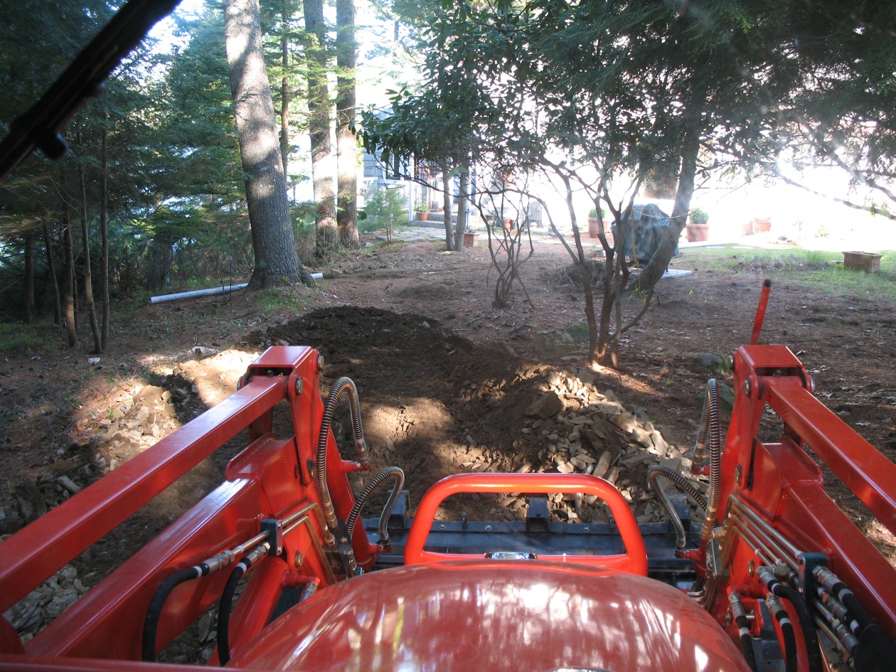

If you want to finish grade with the blade - tilt the box away from the tractor. The outside blade will level material as you go forward. If you want to dig in while going forward tilt the box down towards tractor so the front blade is level or lower. As you move forward this will dig in and pull material. I just finished a 500' section of a 2400' +/- road and also completed a driveway and parking area.
The parking area required leveling rough shale rock before class A. I finished a rough part of drive to house today that will be covered with class A tomorrow.
The pic shows the rough drive to house. I used the bucket and box blade to move and level material. It was a tight squeeze to get path to house!
I will take more pics tomorrow.
