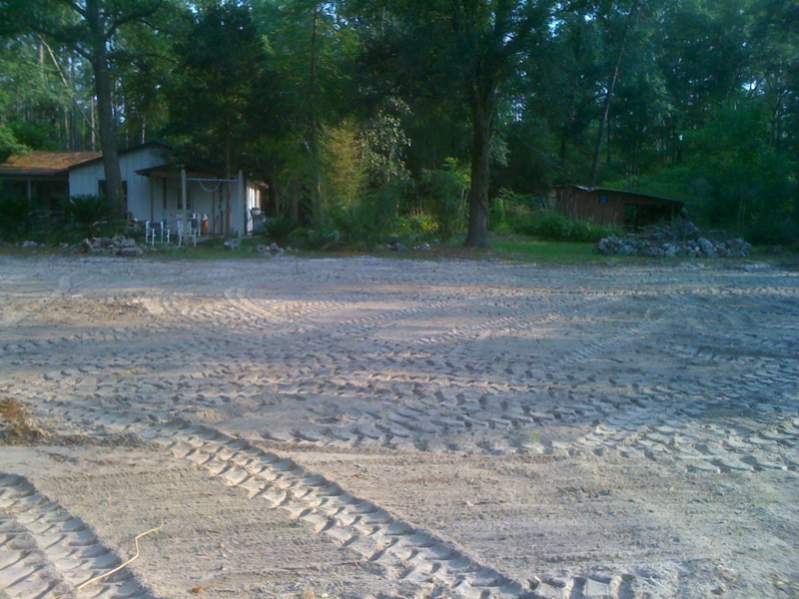

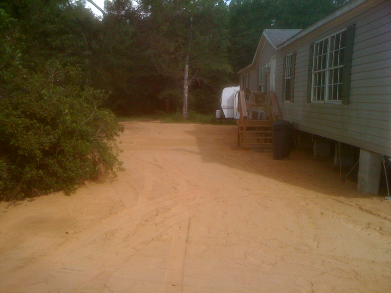

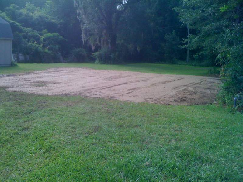

The first thing to do if you are happy with the amount of roots you have removed is to either turn the teeth over or take them out completely, then adjust the top link until the box is 'flat' that way you can work forward or backward without digging up the whole world, then working forward across the cleared area starting on one side of clearing work the high spots into the low areas until you get it roughed in, then working from one side to the other in a grid fashion keep working it finer and finer, all one way one time and then turn 90 degrees and work across the grid working it finer and finer as you go the other way. Working a 'grid' gets everything on a even plane, of course driveways you can't work a grid system but practice makes perfect I have been grading for a living for 30 plus years, it does take time and practice
You have to adjust the box when you feel the front of the tractor move up or down, go slow and speed will come with time
I put in a few pics of some jobs
I call my system of grading using a grid or cross- hatching I used this system grading large areas for concrete for many years, it was necessary to get areas completely level to cut down on hand grading labor
