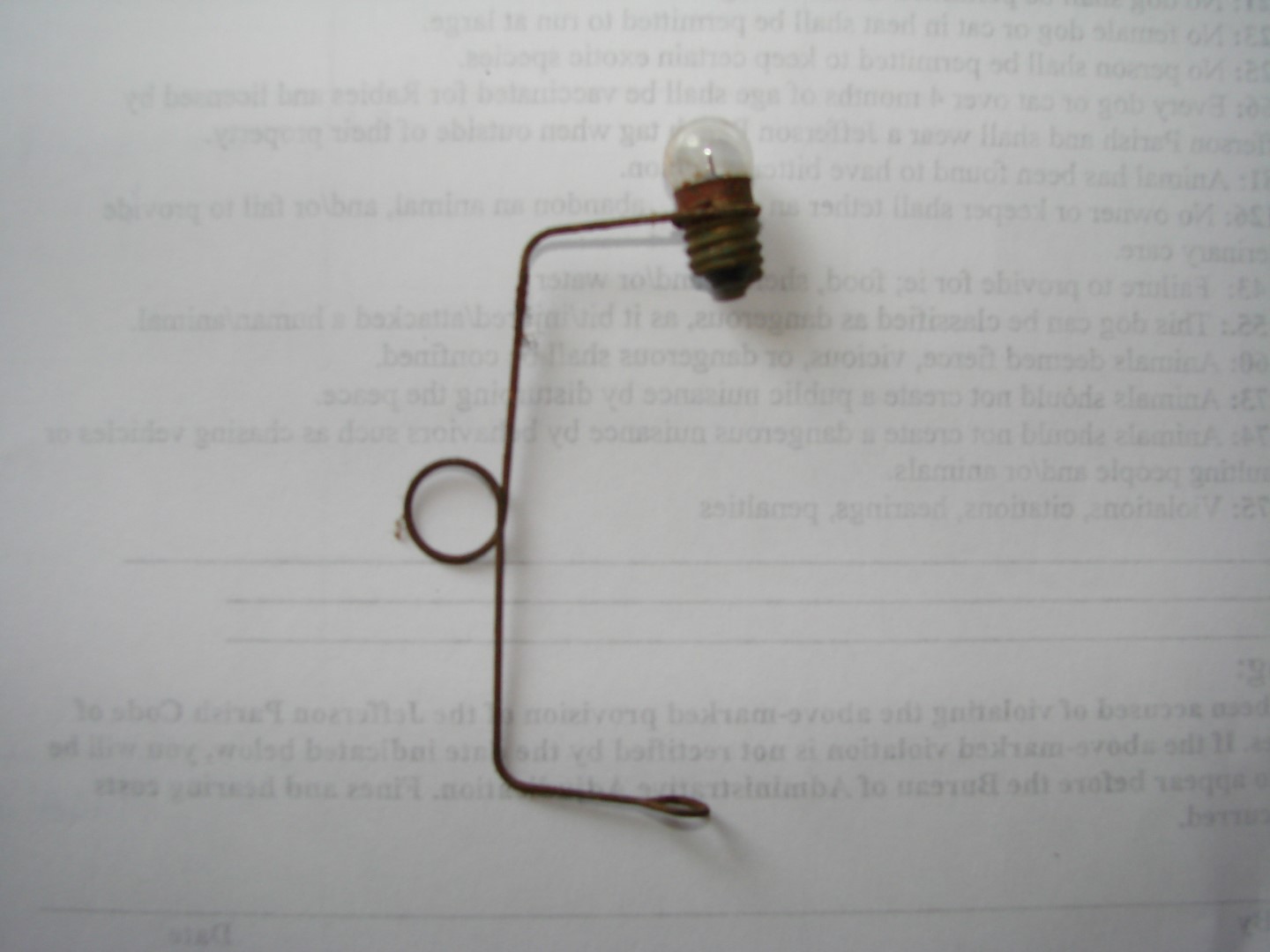

On occasions, I will still use my father's old battery tester which is over 80 years old. It works with all AAA, AA C and D batteries and is much faster than getting out the voltmeter, unwrapping the leads, turning it on, testing, turning off, wrapping up the leads and putting it up.
PS And it doesn't even require batteries to operate.

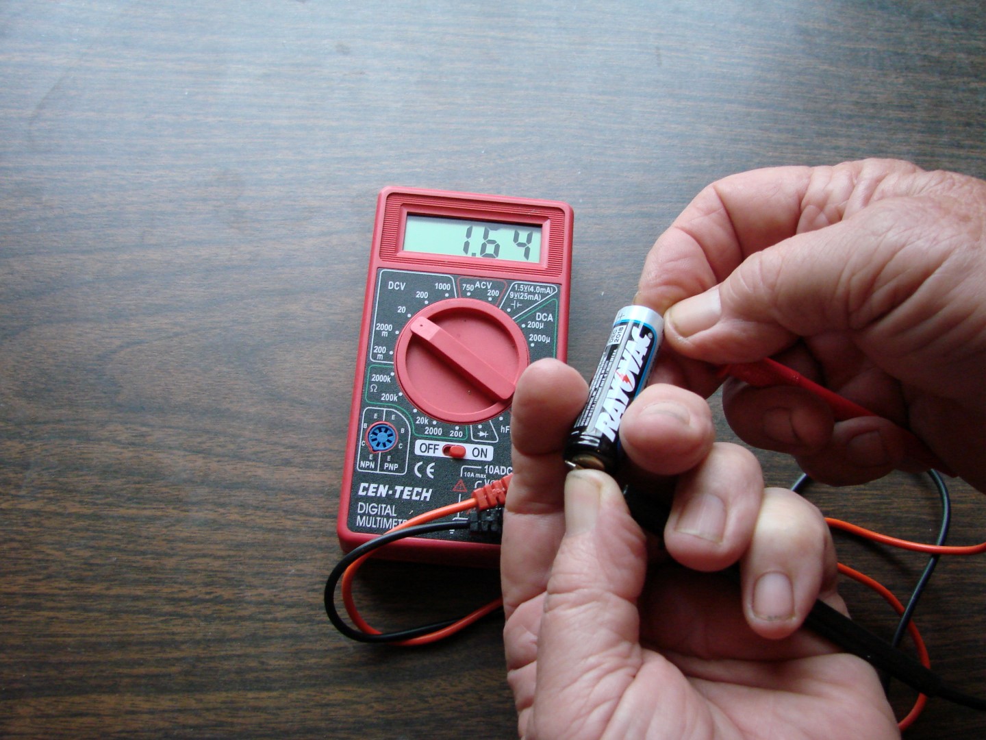

I guess I have too much time on my hands. I checked a few new Rayovac batteries that I have and they all were 1.64 volts on my trusty Harbor Freight multimeter. I checked some new Duracells and they all checked 1.63 volts.

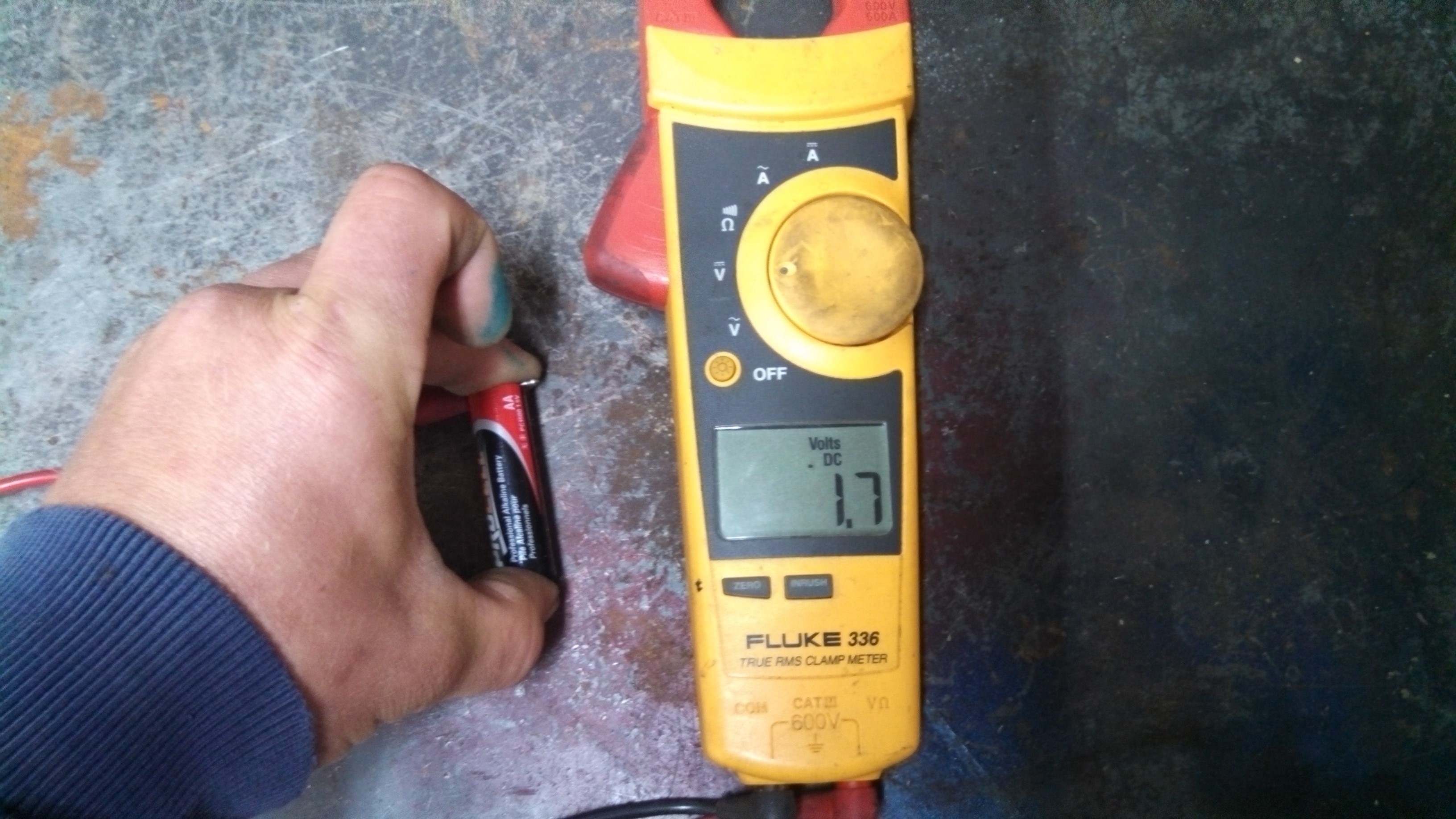

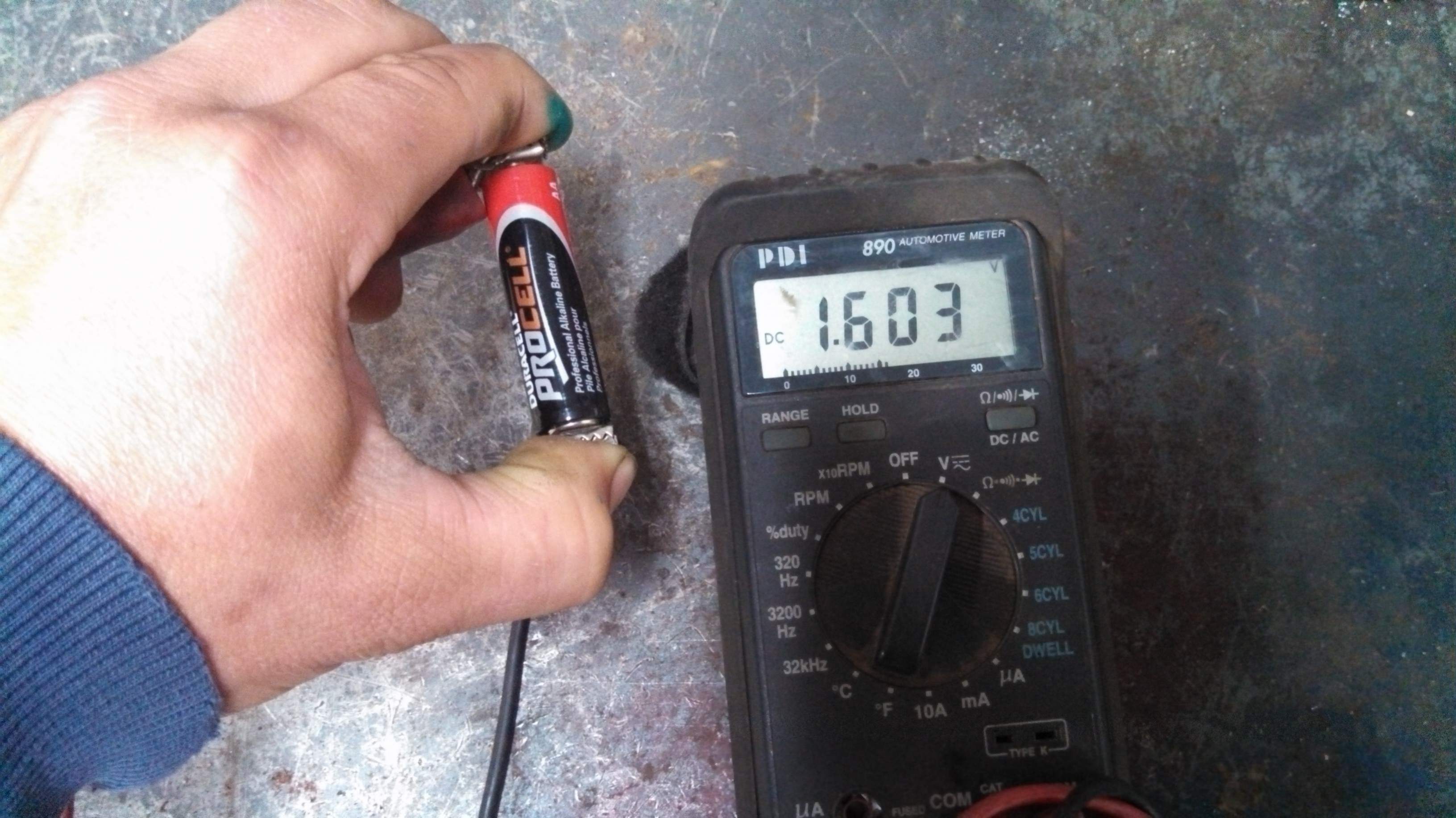

Well, I just checked a new, but about 6month old battery. And got more than 1.58 volts. Thats with 2 good testers. The fluke must round up...;)

LD1.. your Fluke, is not an electronics tech's meter, it is an electricians meter, and has poor resolution for small DC voltages, Only to 1/10 of a volt, and yes it apparently rounds up to the nearest 1/10. An electrician is more interested in volts, not tenths of a volt, but an electronics tech would want at least hundredths or maybe even one-thousandth of a volt resolution to see small trends when making precise adjustments for instance like a trim pot on a power supply. Of course you already knew this, I was just rambling on here for the benefit of someone who might wonder why.
