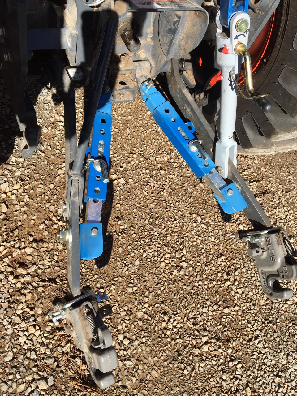

OP, if you are changing implements frequently, consider a set of telescoping stabilizers. They replace the turnbuckles, and are much more user-friendly, as they only require pulling a pin to switch from stabilizing to adjusting/removing.
Mark Hodge, a member of this forum, makes an excellent product for the BX series.
I have a pair... they make life simpler. Work great and good quality. Looking for a link here for reference but can't seem to find one.
   / How to take off ballast box on BX2380 #18
Stabilworks
I have a pair on my '24. Exceptional.

Got a pair of generic telescoping stabilizers to replace the turnbuckles on B26 from eBay. Had to modify to work. Much stronger and easier than turnbuckles. Used extra parts to adapt leveling box to lower link and got rid of another troublesome turnbuckle. If you change implements frequently or do grade work it is so much better.
