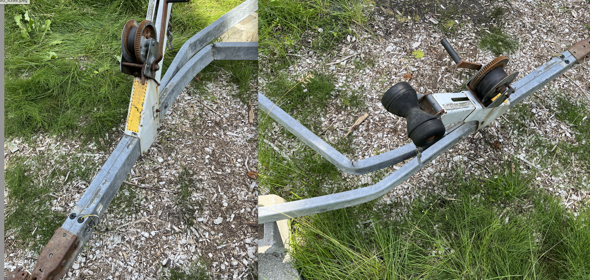

I was given a trailer with a severely bent galvanized trailer tongue (see pics). Any thoughts on how to straighten it. I know, i know .... cut it off and weld on again. That's more money than I want to spend, especially since it is galvanized. My desire is to straighten it so it is squared (pulls straight down the road) and then brace the weakened areas with 1/4" thick 4 inch wide steel plates (which I have) held on with bolts. Possibly add 2 triangularly shaped flat galvanized over and below the damaged area for added strength.
My question is: How do I straighten the bent areas? Unless someone here comes up with a better plan, I'm thinking that using appropriate lengths of 4x4" or 6x6" timbers (to spread the pressure) and use my REMOTELY CONTROLLED (safety first) 5500 lb 12 V electric UTV winch to 'convince' the bend to straighten out. I'm going to run the cable through some 6x12" cement blocks to keep the danger of a broken strap from 'whiplashing' me if it breaks.
Thought about using my heavy duty straps attached to a stout tree truck and attaching the end of the tongue to my tractor. Figured I'd have better control over the straightening with the wench.
Any thoughts appreciated.

that needs to be straightened, but more importantly plated & welded & gusseted.

Yesterday I spent a few hours trying to straighten out what should've been a gentle 90 degree curve of maybe 3/8" rod on a hay-picker-upper thingy.
In retrospect I should've cut it off, beat it into submission, the welded it back on. And if that apparatus turns out to actually function, that's what I'll do once hay season is over.
With profiles like the ones pictured I would just cut out the bent parts and start over. Galvanized or not isn't a concern at this point, it's already toast.

🤣😂😅🙃😜 Dream on but you are basically asking for a silver bullet that doesn't exist. You can't tie loads down on trailers with shop presses and you can't straighten tubing with straps and winches. Looks like a boat trailer worth about $50,look for a used one that isn't beat up and save yourself time and money.

I believe it's repairable but I think it's going to require some cutting and welding.

Did it also bend at the trailer attachment points? Enough to weaken there too? Personally I'd not try to fix that material but if I wanted to I'd look for some trees space so I could put the trailer and hitch ends of the beam against and go at it with a winch as you describe. I'd use angle iron for the repair over flat plate to be more rigid.

There is no bends in the trailer attachment points or anywhere except as shown in my original attached picture. The damaged area was in the original curved area of the tongue thus the weakest area and probably the most prone to bend in the 'ran off the road' accident which caused the bend in the tongue. The 'angle iron' suggestion was a good idea but likely would not fit in the gently curved bend. That's why I thought a drilled and bolted 1/4 inch solid approximate 18 inch triangular piece of galvanized steel above and below the straightened and would strengthen the curved flat plate bolted along the sides of the tongue.

Thanks for the confidence builder. I'm going to try my strengthening first. If it doesn't work, I'll cut out the damaged areas and find another way. The rest of the trailer is in great shape including the 16 rollers. I'm retired at 78 and am measuring my dollars carefully. This is my one chance to have to have a great trailer for only my free labor and a couple/few hundred dollars. I'm tired of loading my boat and motor on to my flat bed trailer to get to the river.
