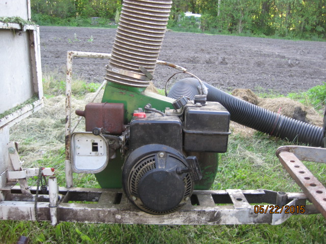

I went to pull start the small 1 cylinder vac engine for my TracVac and there was a very loud raddled as it started then died. On pulling the cord there was no resistance. I removed the cover and a small cup like devise was loose as well as the centering holding bolt. I tried several simple re installations but to no avail. Then the recoil spring shot out of its holder and the rest was ...I quit
Unfortunately on previous posts, I have not been able to identify the engine but with several members help it is most likely a Kawasaki type. One has to use 50:1 oil mix fuel and she has run sweet since. On the inside cover of the coil housing it it MADE IN JAPAN ..SKK..
Question: how does one rewind the recoil spring? Are there professional secrets?
Photos of the engine etc attached.

It's best to show pictures of the recoil. Motor pictures doesn't help. Have done 100's and there is a right way of doing them. Just maybe it's one I have done before.

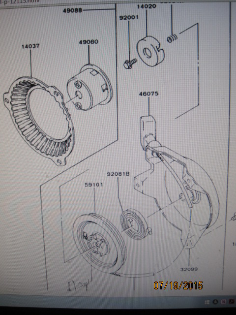

If you are lucky there is a notch on the top edge of the rope reel. Get it all together with the spring loose and about a foot or 18" of rope hanging out where the pull grip is. Push the rope in while pulling up a loop thru the notch. You might have to make the loop before you seat the reel if it sets in a cup. When you get the loop just use it as a handle to wind the reel backwards keeping the loop in the notch. Wind back to the desired tension plus a little then pull the loop back down onto the reel where it belongs and let it wind in. Hard to explain but you should get it with a couple trys. Good luck.

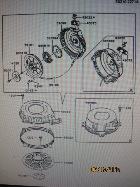

Leejohn: I found schematics which I feel accurately show my pull type recoil starter. It fits the Kawasaki fa210D pictures.
The bolt 92001 had come loose and the cup 14020 was rattling inside the case. I reassembled them and rebolted the housing to the engine but when I pulled the cord there was no resistance. I could not determine how the cup 14020 engaged the 49080 cup to turn the engine. then the darn spring popped out and the rest was...I need tips on how to get it back together.
gg
This is the right way. Good description GG; I call it winding forward tho.
