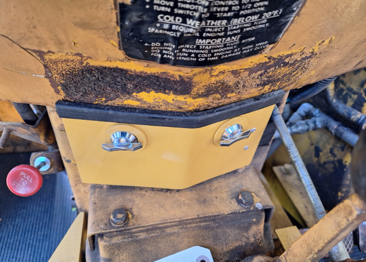

It is really tight around the orbital motor so hoses are most likely not viable. I know that anything under the dash on the 20C/30B is a pain to work on as MF welded the whole front console of the tractor up solid so its impossible to access anything. The previous owner on mine cut an access hatch in it. You can see in this the cover I made for it. It helps a lot, but access still sucks.
